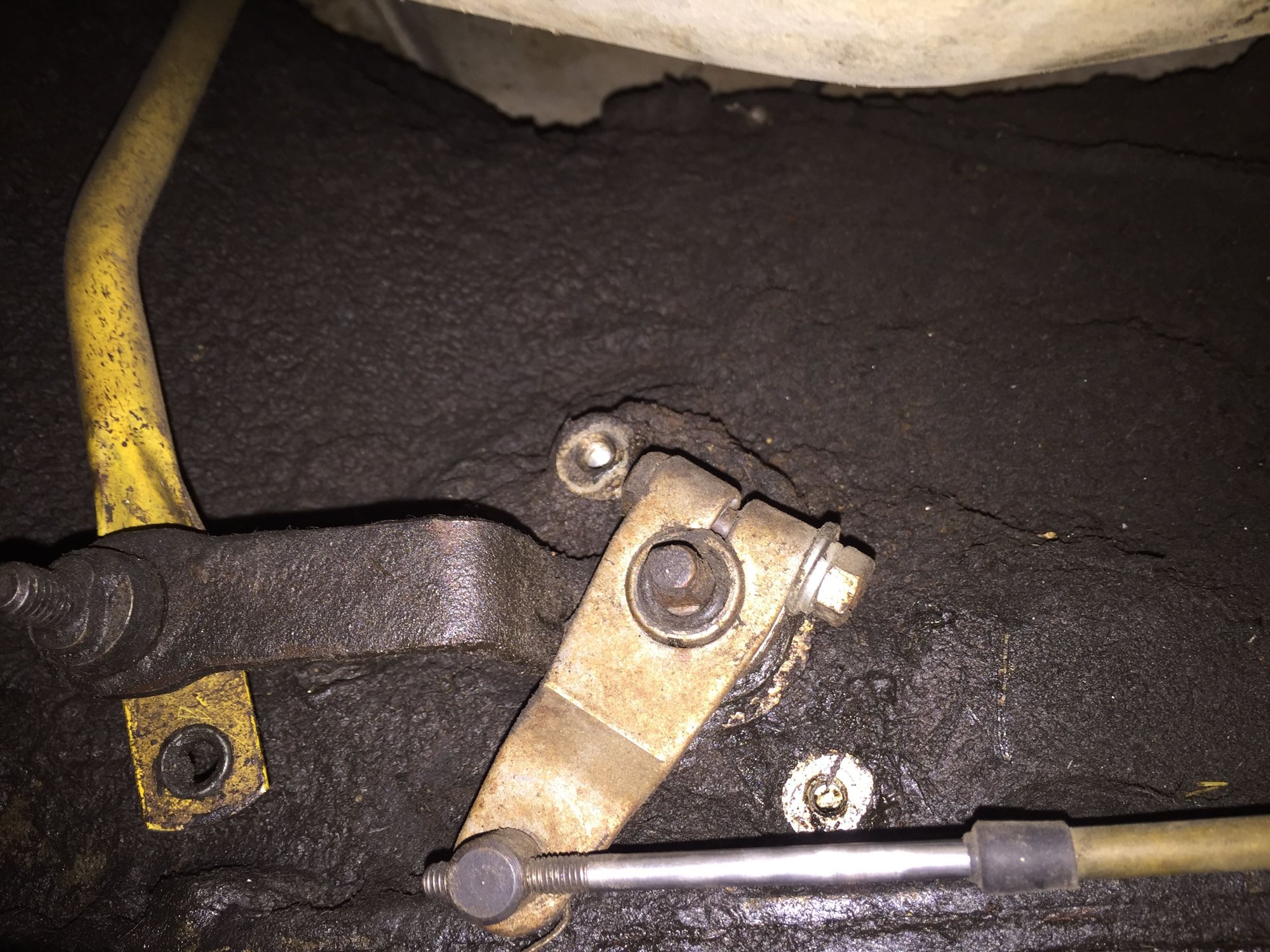

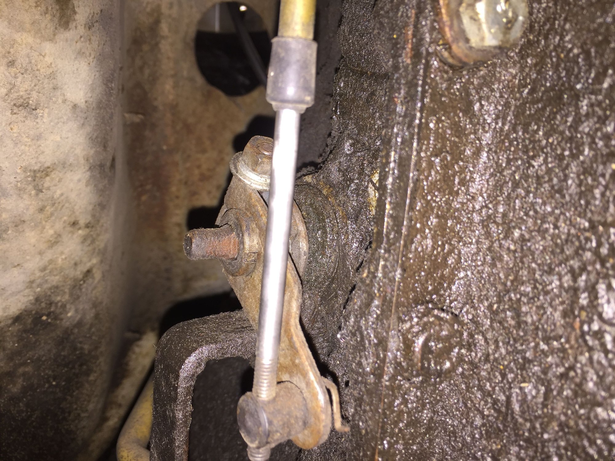

I did the opposite and restored the column shift from a floor shift. The PO had put in a B&M floor shifter. The removal was very straight forward. Its a cable shift and I never had issues shifting with it while it was being used. The linkage bracket mounted to the transmission using two of the oil pan bolts. there is an adjustable rod at the end that hooks into a clamp that goes over the transmission shift linkage. Mine is a '78 C6 so the clamp goes where the NSS mounts. I think the hardest part will be getting the angle of the clamp right so it shifts smoothly. I'll find some pictures and send them over soon.

Pretty messy but you get the idea. I guess I don't have any pictures of the mounting bracket itself.
