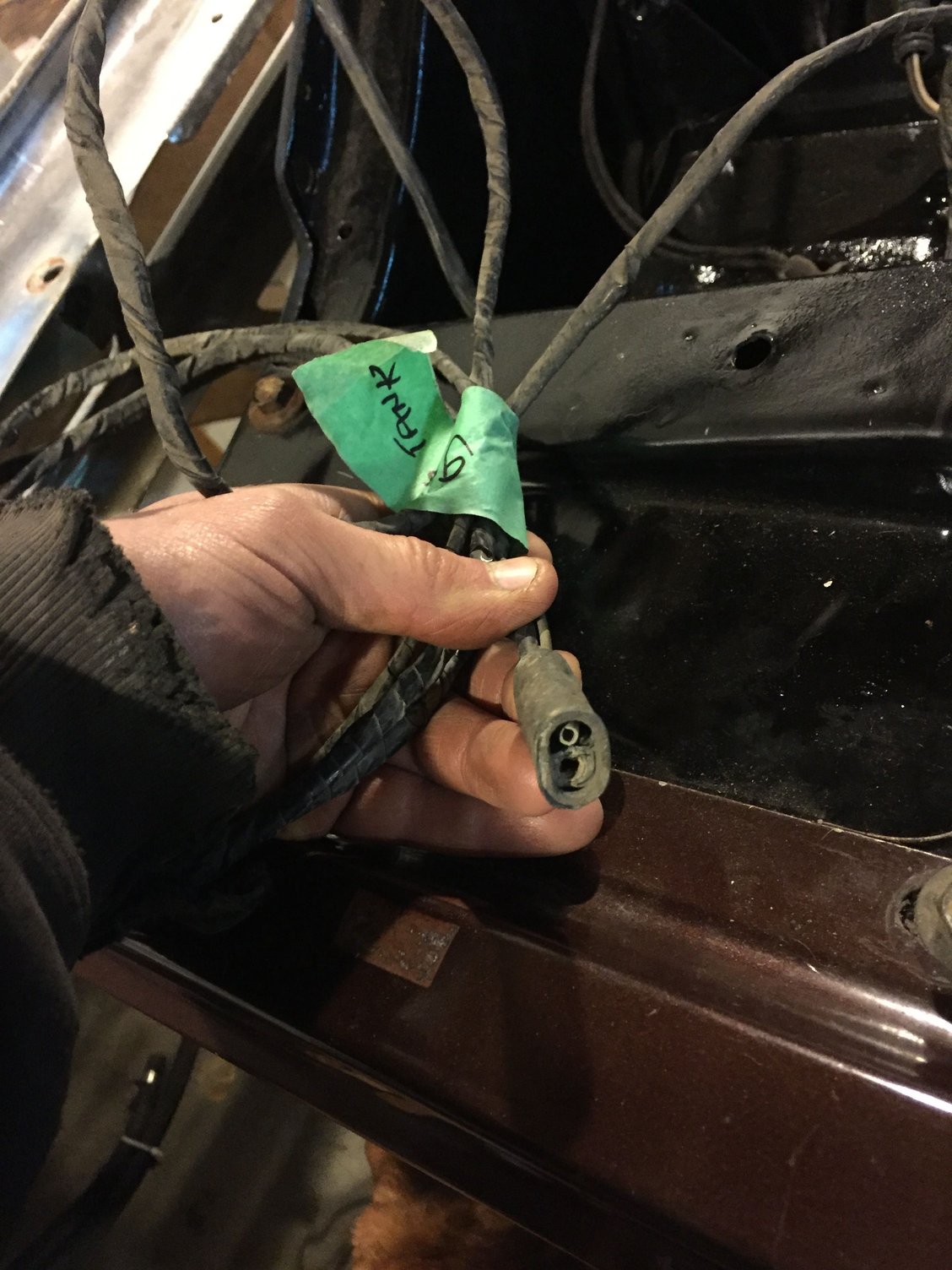

sorry heres a picture

Are the two wires light blue and white with a black stripe?
If so, that's the plug for the electric assist choke (white/black) and throttle kicker solenoid on the carb (lt. blue).

Posts: 184
mike
the wires are (olive green with orange stripe) and a (thicker black).
this is also the harness from the 79 400/c6-auto 2wd

Well, this one stumped me. On the schematic, all the plugs that match the one in the picture don't have the correct wire colors .
Looks like it's time to trace them back and see where they go.

Can you show a picture of the plugs relative position when the wiring harness is fully run. As in does the plug naturally sit right behind the cab, end of trans, gas, tank, or hitch?

gijazbo
you got me thinking its something to do with a tow package. im going to put this one aside for the time being.

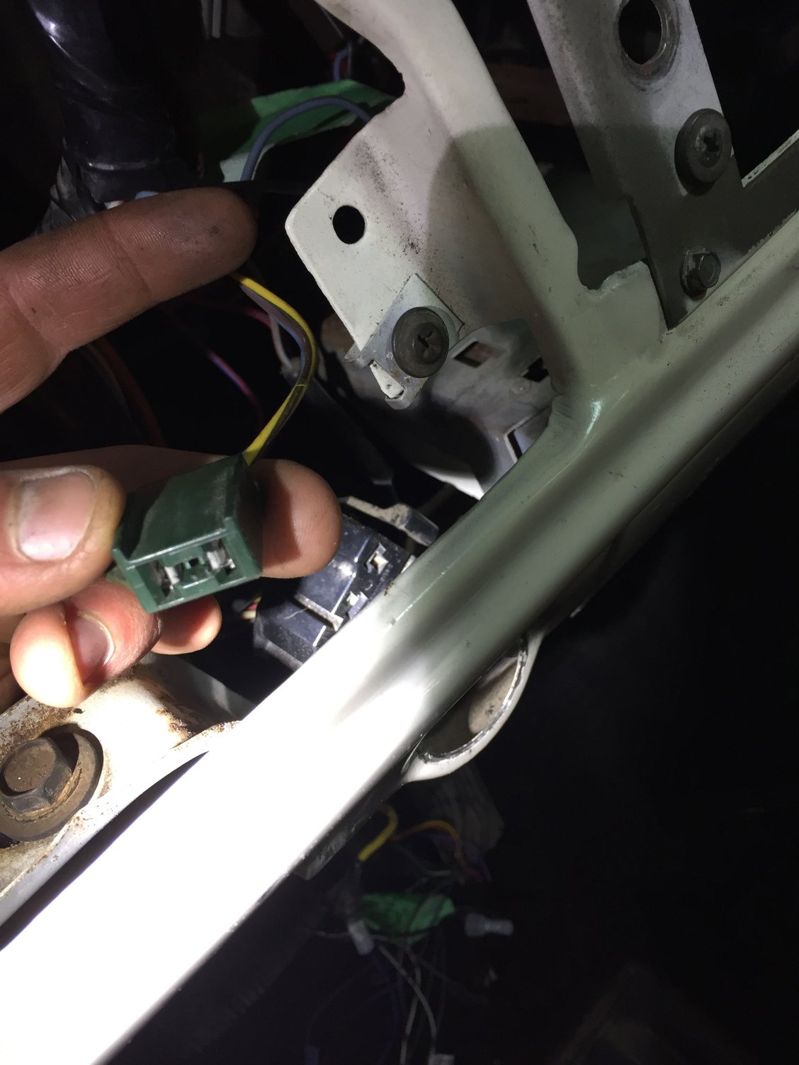

next question:
plug that comes out near radio area(see picture). what is it?
and also can i just unplug the seat belt plug? i assume its just for the buzzer?
thanks again guys

Originally Posted by dthut
next question:
That one is the factory radio plug. Blk/yellow, keyed power source. Lt blue/red power for the radio back light.

77&79F250 in post 7 and 9 of this thread will help you out.
https://www.ford-trucks.com/forums/1...-a-stereo.html
Radio switched power and ilum.
