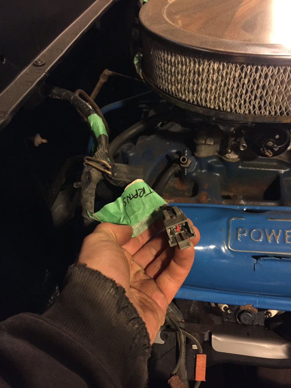

question #3
the harness from my 79 plugged into my transmission (400m/c6)
But the (390/c6) that i have in it now from my 74 didnt have a plug to mate.
Is this something i can just leave unplugged on the harness?

That's the NSS, neutral start switch. It controls both the neutral start and the back-up lights.
73-77 the NSS was mounted on the steering column. In '78 it was moved to the side of the transmission.
I would recommend installing it just for the neutral start if nothing else.
To use the 73-77 style switch, you'll need to swap to the earlier steering column.
To use the later switch on the earlier trans, two things, first, you'll need to be able to mount the switch on the side of the transmission. There are two bosses that are cast into the transmission case. The earlier case may or may not have them. If it does have them, they may need to be drilled and tapped to mount the switch.
If you can mount the switch, you'll need to swap the manual gearshift selector lever. These will interchange between the two transmissions without problem. You need to pull the pan and remove the 7/8" nut that holds the arm in.
If push comes to shove, you can bypass the neutral start function so you can start it by jumping the two wires in the plug.
