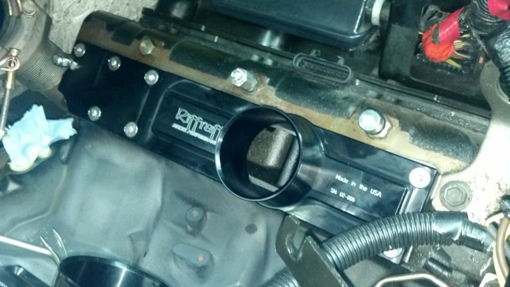

Originally Posted by Tugly
Yeah... my "neighbor" Woodnthings did the first set and a write-up with it. There were several modifications by the time I installed my set, and the last time I looked - there is no slot for the bolt under the HPOP. The 10-bolt intake plenum is supported enough in the corner that the 10th bolt slot doesn't need to be there.
Stock:
The new billet plenums:
good to know! I am wondering if the flat plenums like the ones Irate sends with their t4 kit is the same way . If you ever want to do a s400 or big Garrett turbo you need the flat plenums to clear the turbo
Stock:
RR
Irate

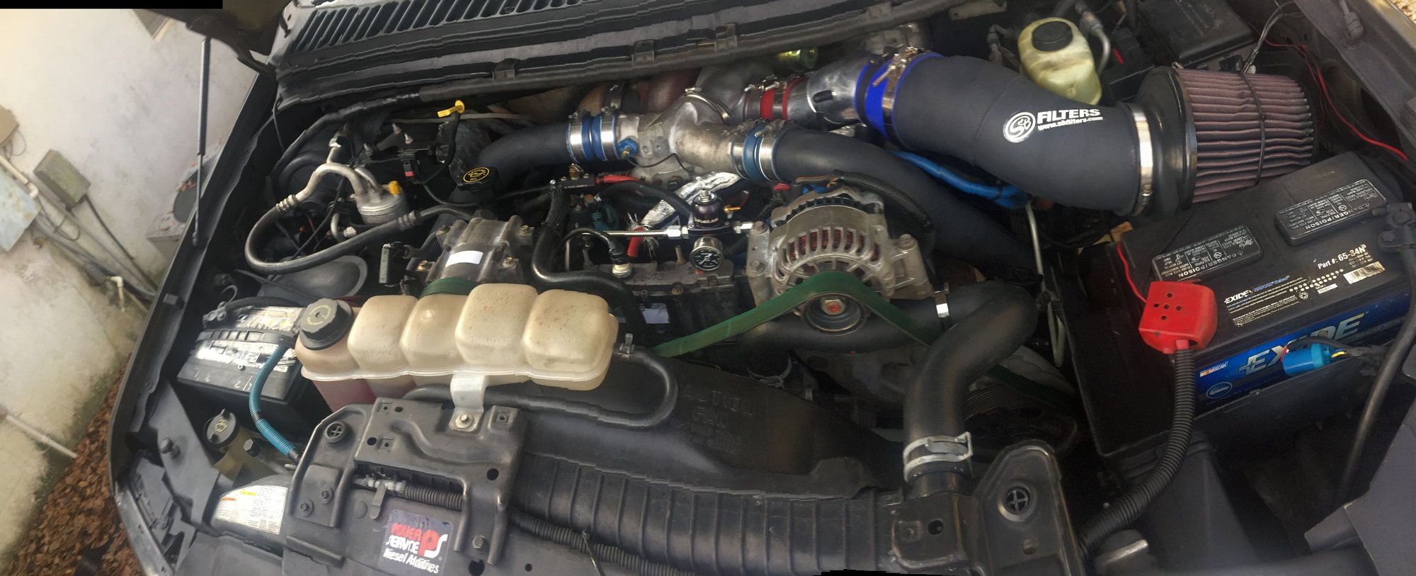

Originally Posted by Walleye Hunter
Your engine is clean already but I'd recommend getting the area as clean as possible and blow any loose stuff away with an air hose to prevent it from dropping into the intake while the plenums are off. One of the first things that I did was disconnect most of the engine harness and lay it over to the left side of the engine and out of the way. EBPV solenoid is easily broken and if you don't already know it's best to remove it from the pedestal before you break it. For the most part it is straight forward.
My engine
