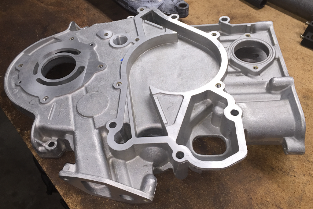

Many have found solutions to re-sealing the oil pan with mixed results - engine out or not. Once you factor in the front cover, I've done that on the stand - and I would never want a piece of that under the hood. Once that oil pan is off, you're already into the truck with quite a bit of work - but factor in getting the dampener off, the oil pump, the fan, the water pump, the oil cooler, the fuel bowl, the HPOP... all while not damaging the radiator, your knuckles, or the neighborhood children's sensitive ears....
That front cover is really a thing... you're in it now. You might as well ask if you can replace piston rings with the engine in the truck. It can be done, but it's quicker/easier to pull the engine - even when you factor in the labor/time to remove/install the engine.

Heads off to do cups? Might I suggest you don't pull the heads next time - I've done cups and helped with cups without pulling heads or engines.
You will discover the front cover doesn't come out - not even with all the visible bolts off. The oil pickup tube is bolted to it inside the oil pan.

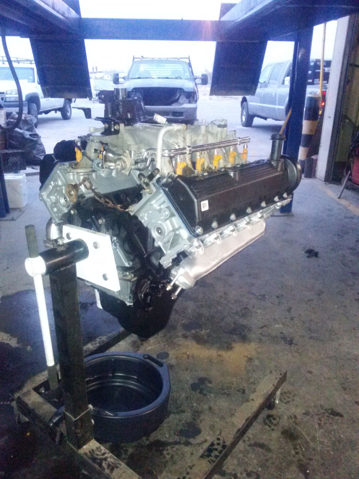

I've never pulled an engine - I bought this one to replace the one in Stinky. I know you need the fuel line quick-disconnect tool for the fuel supply and return line - available at any auto parts store. I've been told we need to pull the turbo to get the engine out, and to jack the transmission up to get the engine back in. I'm not much help here.

You can use the quick disconnect tools to release the fuel lines at the drivers lower side near the ground for the block.
I pull the motor with mounts attached, just remove the two nuts per side from the engine cradle.
Make sure:
-Torque converter nuts pulled and pulled back into trans so it doesn't fall out of bellhousing
-If auto with slip joint and carrier bearing, can loosen the trans mounts and carrier bolts and scoot trans backwards
-Harmonic balancer can stay attached
-I pull water pump with fan and clutch as one assembly
-engine harness disconnected at drivers valve cover
-Drivers lower ground disconnected
-Accessory brackets disconnected for more clearance
-Radiator pulled
-Intercooler pulled
-Condensor protected but can stay
-Hood pulled (this way header, headlights, grille can stay)
-Turbo pulled
-Pull A/C compressor and set aside (Do not let it sit so oil can run out into main lines)
I would not even try to reseal the pan OR front cover unless I pulled the motor. There are three spots on the front cover that require TA31 sealant (Ford spec grey sealant) where the o ring does not seal; across the top and then two spots on the lower portion. Ford offers a timing cover reseal kit with the International gray sealant, o rings for the timing cover, HPOP reservoir gasket fyi.
