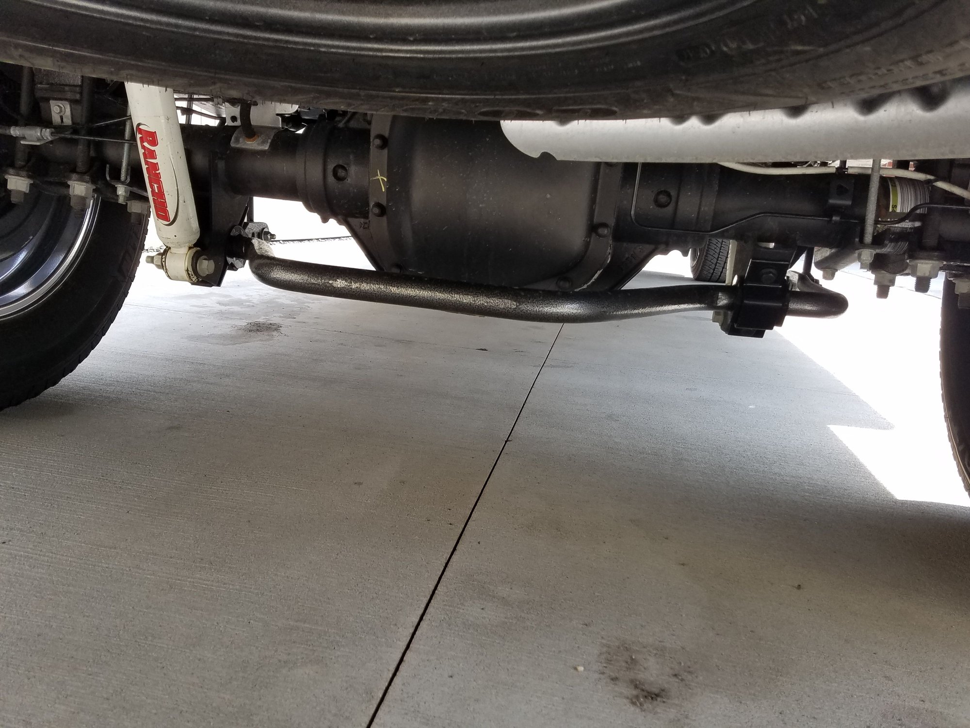

Hellwig bigwig.

Originally Posted by workingdan
Hellwig bigwig.
Much more intelligent-looking installation than on my F-150.

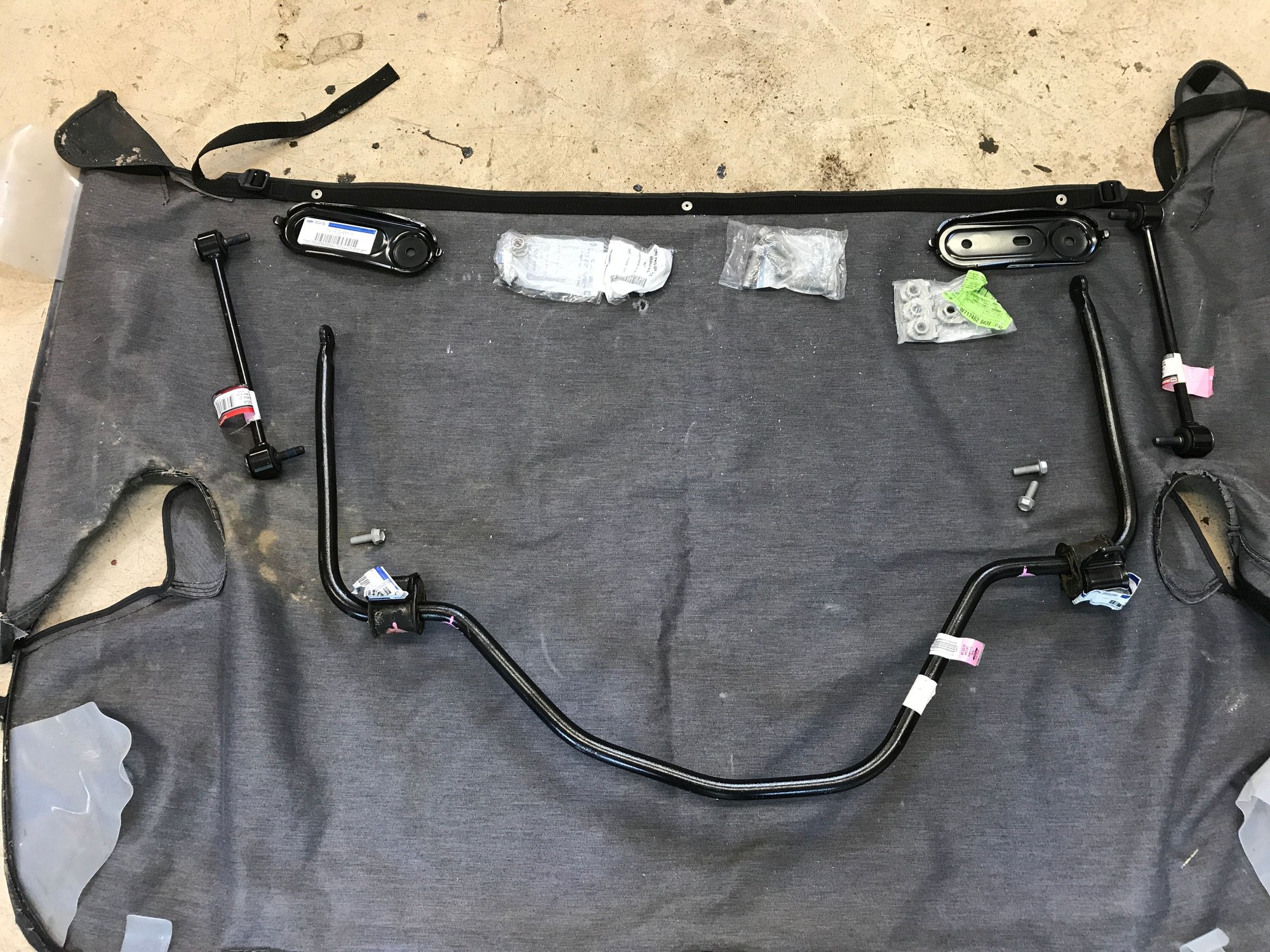

So all my OEM parts are in.

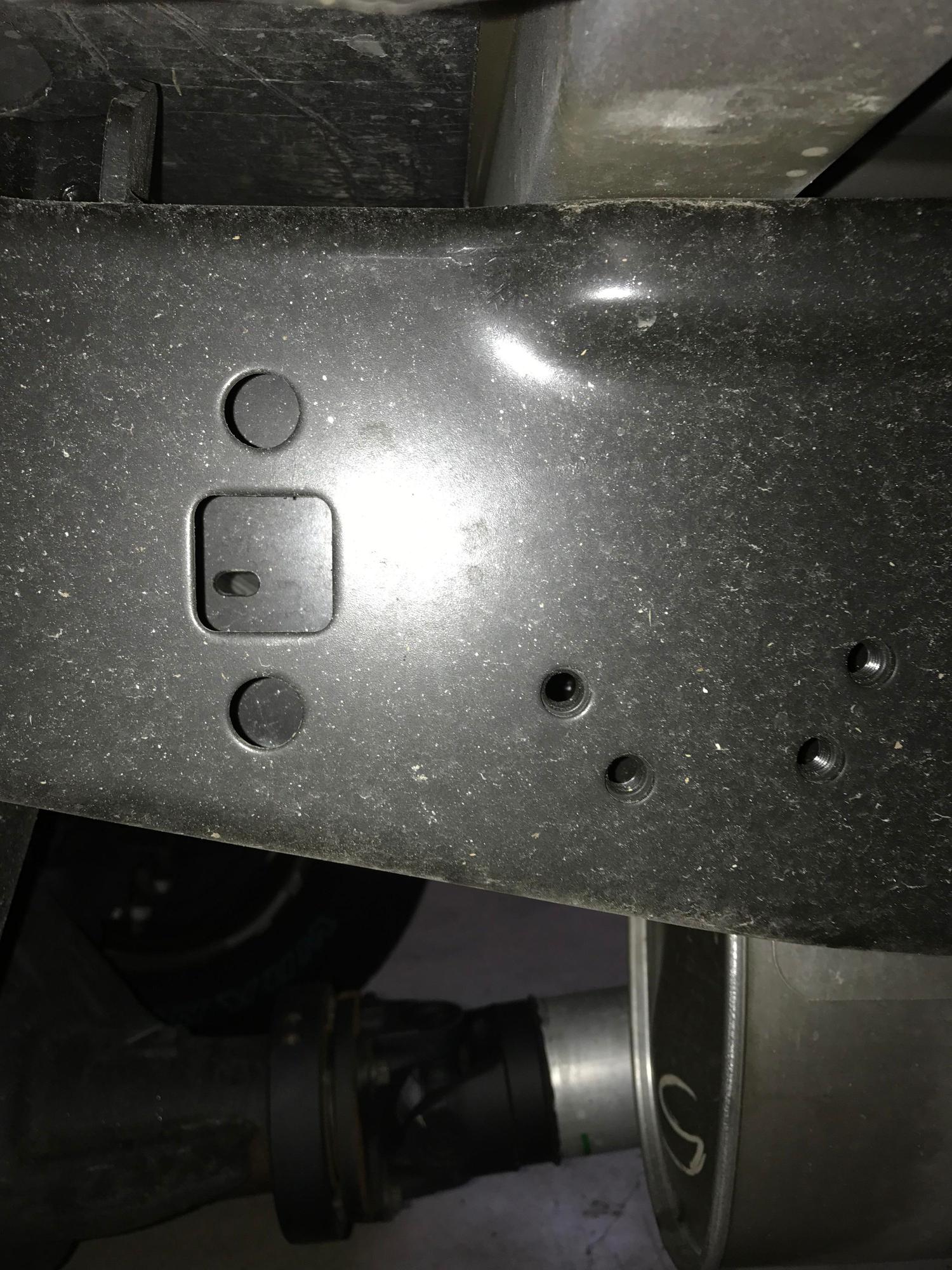

Here is a shot of the frame holes for the brackets
Here are the parts laid out.

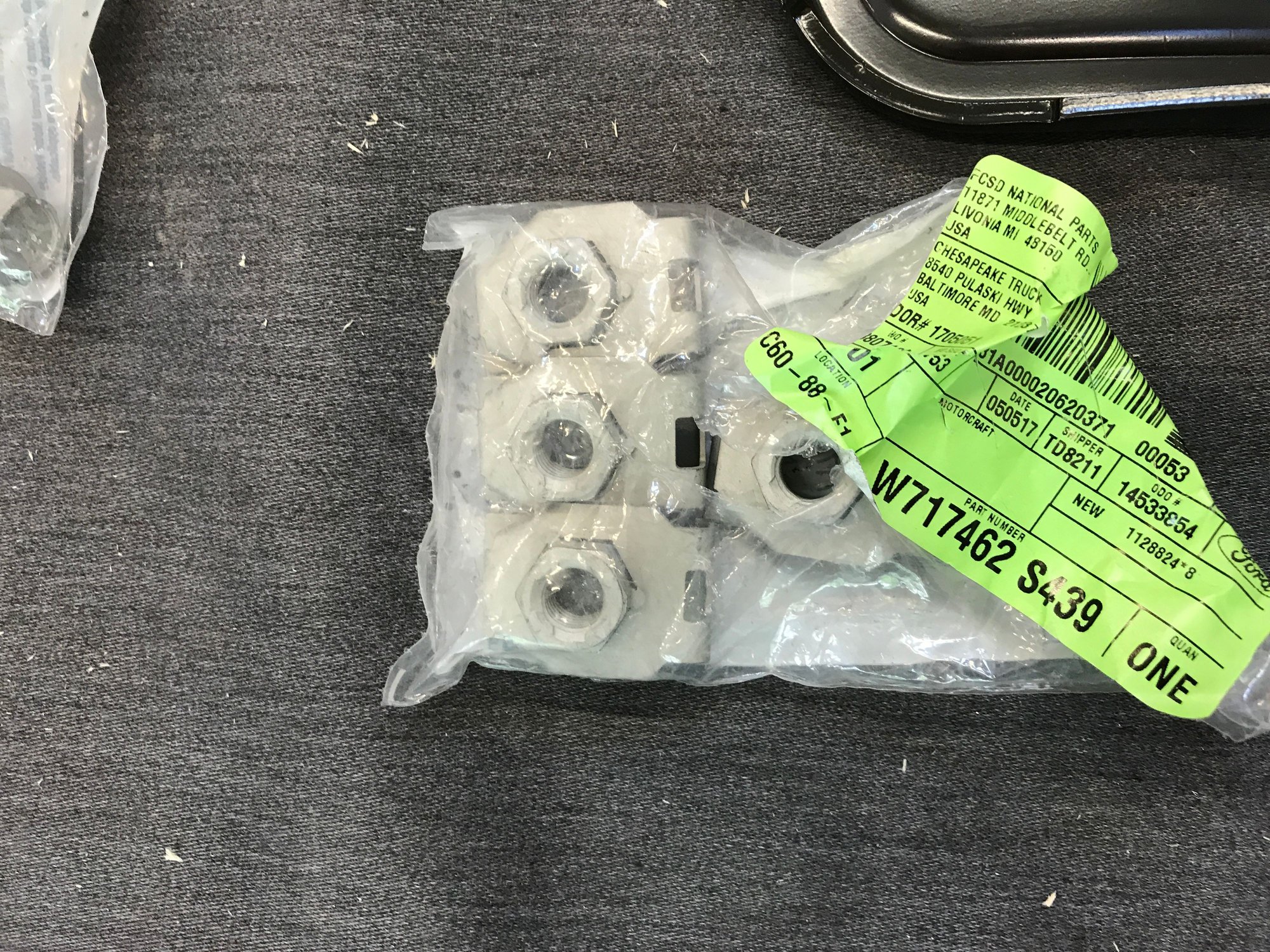

These nuts are the secret to not having to drop any tanks and to work with the boxed frame.
I'll try to post up our steps for the install.

Do you happen to have the parts number on the bushings?

The bushings are on the bar. As far as I know, they are not separate.
