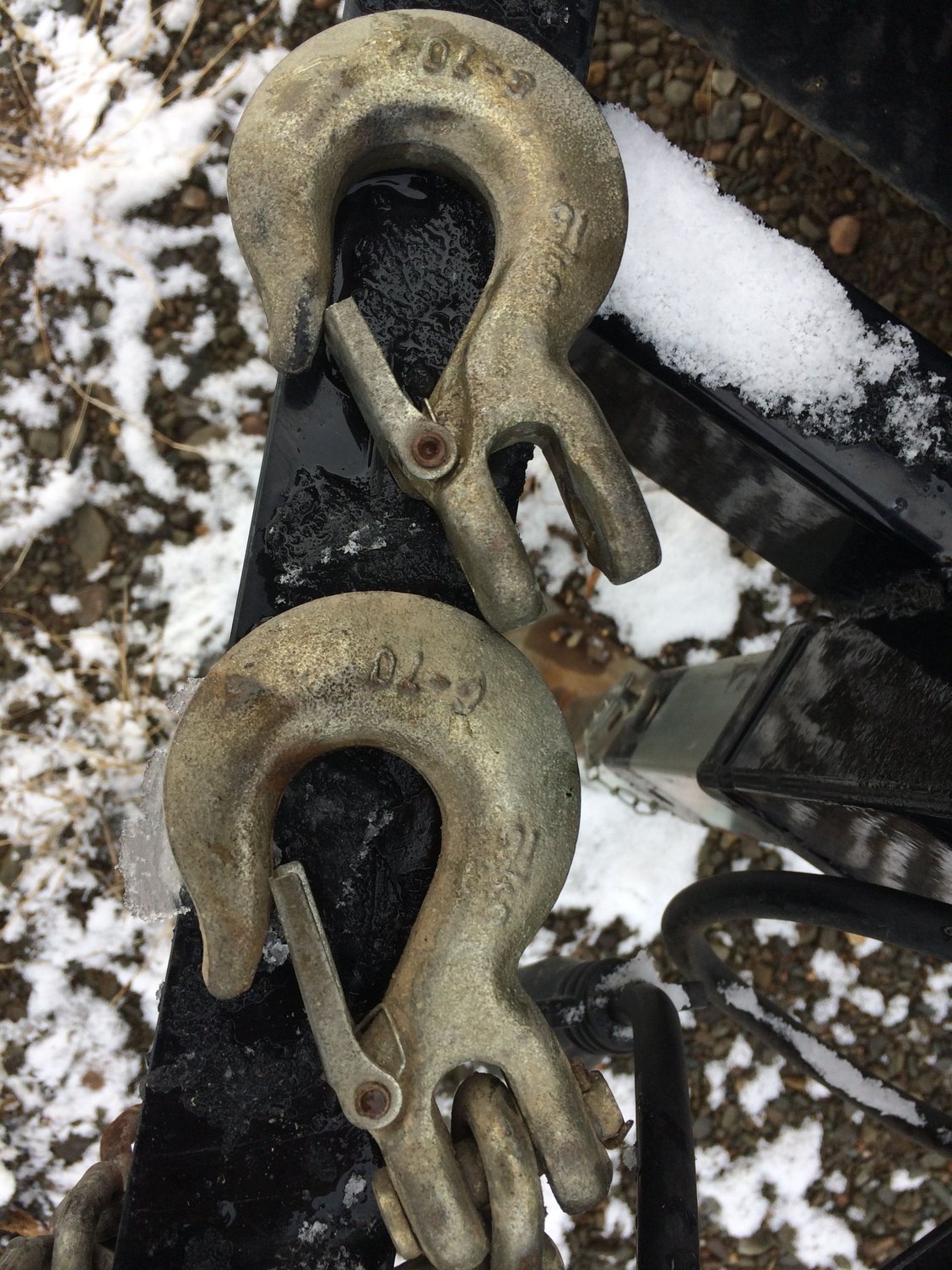

Posted this on the "things that you don't like" post as a fix for some who already have the 5/16" hook.
I have 5/16" hooks on my larger trailers and it was a pretty easy fix for mine to fit. I just cut about 1/4" off the end of the spring latch.
cut 1/4" off and it fits just right.
See the piece I cut from the first hook on the vice jaw and the cut I made on the second latch. A quick cut with the hacksaw and it's done.
