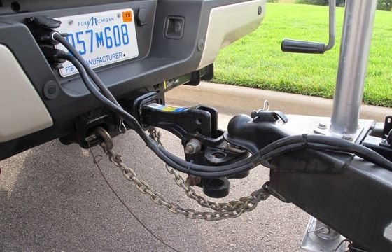

I've NEVER had a trailer come uncoupled and I understand all the aspects of the safety chain holding the weight of what you are towing but there's gotta be a simple solution. That giant "Made in China" looking hook in the one pic should be thrown away anyhow! Lol This set up looks much better and it's on a 17 SD
Ideally you want the hook to hook onto the receiver hitch and I think with a quality hook it will work! The problem most trailers have some "China" made hook with tons of extra meat and half the rating like most other China crap.

What is the second plug plugged in in the pic? Is it the rear trailer camera?? Looks like it is in the position of the 4 plug connector on the back of my bumper w/o the external camera.

Technically your chains are hooked up backwards, I have always been taught to hook the the openings up, or facing the trailer, if the tongue drops they will hold the tongue if crossed, and the weight will rotate the hook into their throat. your way it rotates the hooks onto the saftey lock which could break.
That pic is from FORD MOTOR CO. have to tell them that. Notice the "manufacturer" plate. That's one of their rigs hooked to a trailer. Nice observation though.
