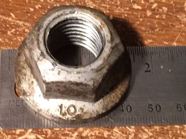

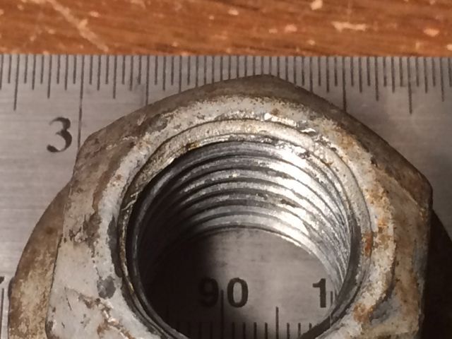

Being a flanged nut I think he won't make much headway from the nut side.
I happen to have not dumped my scrap metal box yet and still have the bole
and the nut. As you can see from the nut it looks like it has upset threads to
help lock it on. When I tried to screw it down once I hit the end it got really stiff
do to the locking mechanism. This may or may-not be factory but it does feel
like a self locking metal nut.
I can tell you that the last person to have this off (Less Swab Tiers) did not torque
it correctly. t did not take any major force to take it off. It felt more like 250Lb/Ft
and not the 406 Ft/Lb it should of been.

They are lockouts, along with many of the chassis nuts. In the shop we called them pinch nuts because it appears the top 2 or 3 threaded area was pinched on the flats to oblong the hole. They are suppose to be a one time use nut because every time you loosen them they loose some of their holding strength.
Here's a sample I found on the web. You can see the deformation.

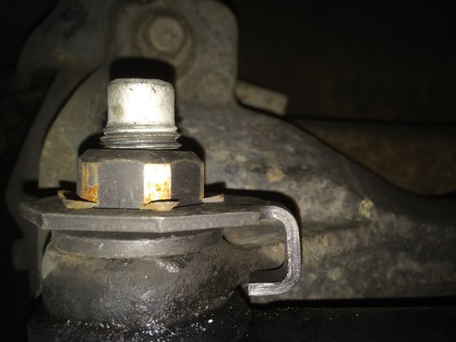

I got the shots of the track bar nut and bushing for you to kook at.
Sean

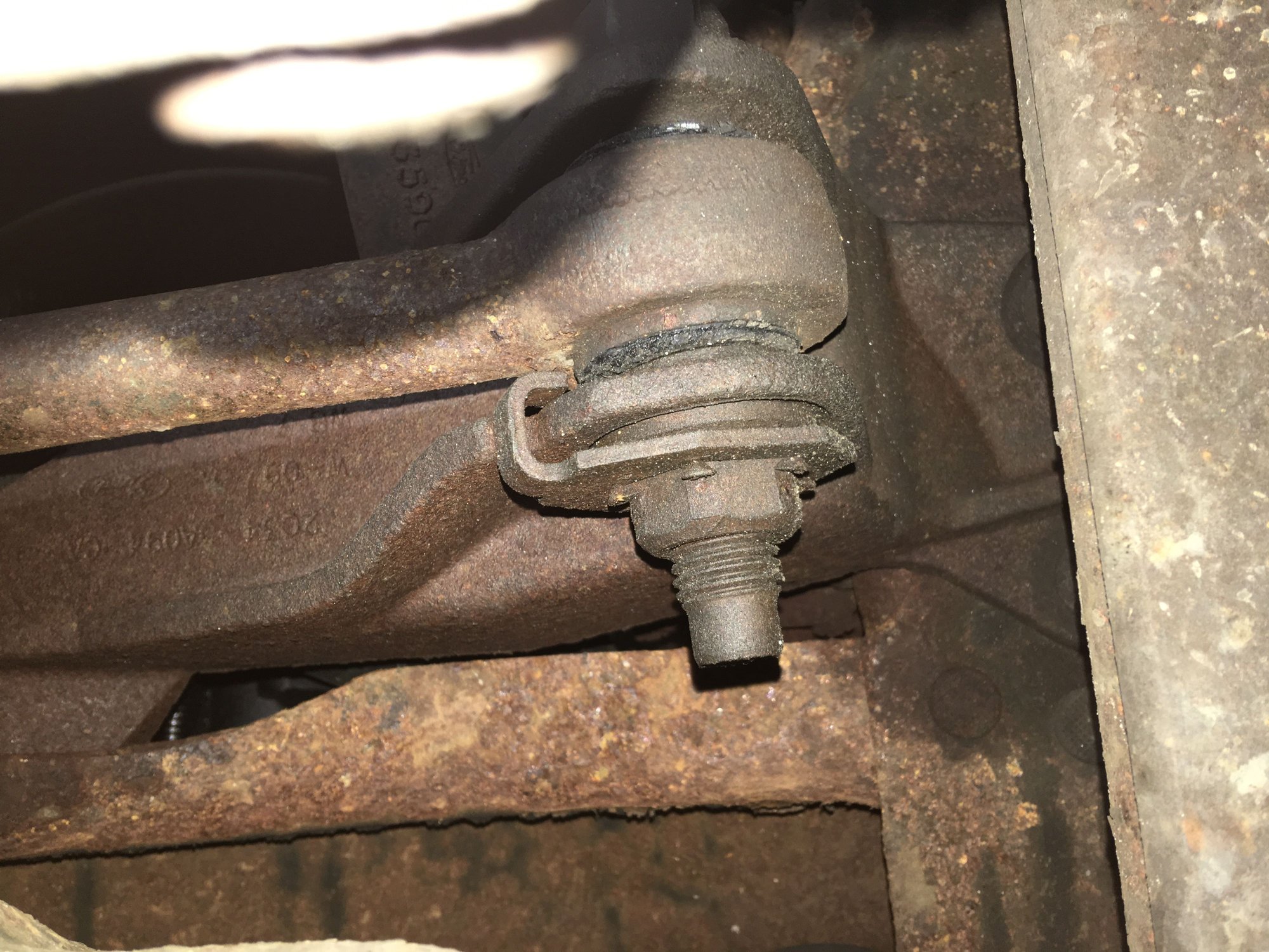

Is that nut suppose to be welded ? And just the bolt comes out? By the pics from Sean it's got fillets .
Old Oct 24, 2016 | 07:11 PM
TooManyToys.'s Avatar
TooManyToys.
Joined: Dec 2014
Posts: 17,832
Likes: 3,119
From: Jersey Shore
No, it's designed for quick assembly at the production line, with only a torque limited nut/bolt driver from the one side.
The nut is swaged onto the flange (actually it's a flange nut, the separate flange, then the peaks of the nuts hex are swaged to capture the separate flange), then as its assembled at the factory the flange will lock onto the brackets arm to resist turning. Fords only concern is assembly. Sean's image doesn't show it in the factory position, this is.
