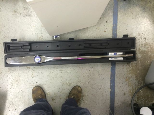

Old Aug 6, 2016 | 09:42 PM
Yahiko's Avatar
Yahiko
Joined: Apr 2012
Posts: 27,307
Likes: 549
From: Spanaway
Well the last of the parts came in today. Thank You Ed.
Yesterday I picked up this beast that can do 600 Ft/Lb. I think it will find that 406 Ft/Lb is easy.
After all it's only 2/3 of the capacity.

Old Aug 6, 2016 | 10:01 PM
geniusloerts's Avatar
geniusloerts
Joined: Oct 2011
Posts: 130
where did you find that beast at?
Old Aug 6, 2016 | 10:19 PM
Yahiko's Avatar
Yahiko
Joined: Apr 2012
Posts: 27,307
Likes: 549
From: Spanaway
I go to this pawn store that I know the owner at and he looks out for me.
He has some of the best goodies.
6004LDFNSS is a $800ish torque wrench if I was reading the pricing correctly.

Old Aug 6, 2016 | 10:28 PM
Tideman's Avatar
Tideman
Joined: Nov 2008
Posts: 1,443
Likes: 9
From: South Alabama
Wouldn't do me any good to have it. I couldn't make it click or read 460 lbs. ;-)
