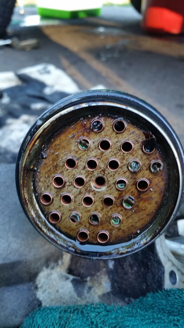

Plug found...
Oil cooler... F****r...
Oil fins look ok. But I'm just gonna get a new one .
This one is pretty rusted anyway from being on the beach so much...
Good news is, it's the cooling side plugged and not the oil...
I'm sure it's all crap from diesel in the coolant...
Question is, where did all the little metal pieces come from? The rubber I'm sure is the thermostat gasket... the metal looks rounded like copper maybe.. but they're tiny like the oil cooler pipes...

Ok.. So I have replaced the water pump.. and the Oil Cooler (it was clogged up with crap from when the injector cups went bad ... diesel degraded some stuff and it got in the oil cooler...

That greenish stuff is copper, and it didn't come from the cups - they're brass. The pump is aluminum and stainless steel. The radiator could be dissolving and leaving deposits, but that would mean a bad mix of something in the coolant - very likely low SCA levels for a long time.

Can the green crud in the cooler be cup adhesive? It's basically green Loctite right?
