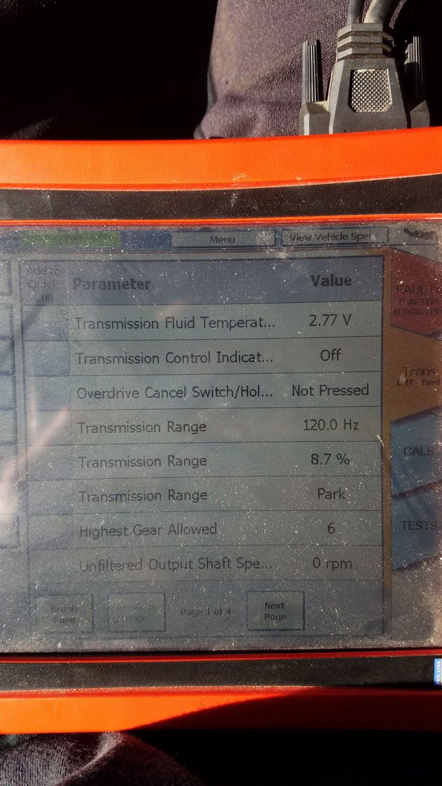

So driving the other day and tow haul starts flashing. I come to a stop sign and goto take off and it barley takes off. It will barley roll if my foot is off the pedal sometimes wont even roll. Also won't shift into 6th. Once it gets rolling though say till about 25 it's fine. Just doesn't wanna take off? I scanned the trans but got no codes. And here are some pressures and stuff but I don't know what I'm looking for with the trans. This was all done in park.

The pressures are meaningless. Those are the pressures that the PCM wants. Those pressures will always be right.
I can't believe there are no codes. This trans is good at setting codes when something is wrong. Without codes all anyone can do is guess.

Well I just re scanned it and have a bad shift solenoid d so that's my problem right there.

Did the scanner finely give up a code ? , sorry I wasn't much help , but still glad you found a lead instead of a hair puller

Yep p0983. And yea I was just gonna go buy a new trans and say screw it glad I re scanned the thing just saved a ton of money

Right on , that would have gotten expensive, even though no light is on don't mean a code is not stored , something we all kind of forget
