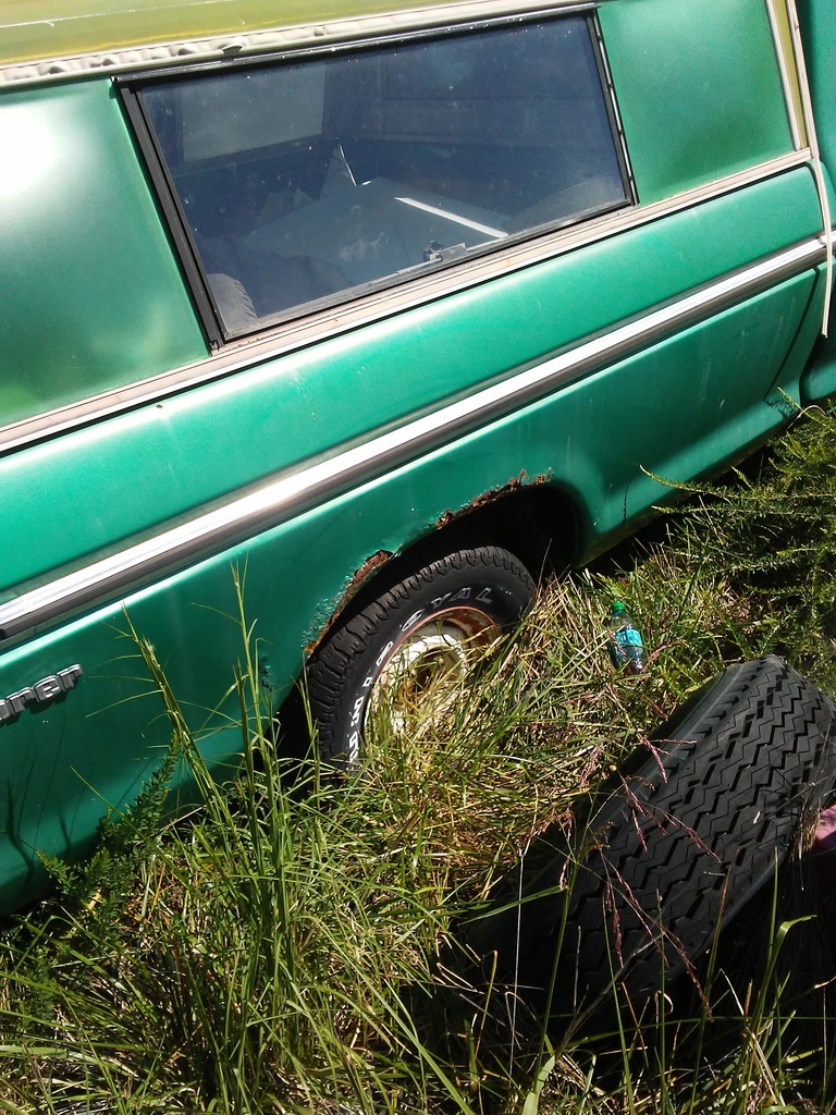

I got this truck on 9/2/2016. Been looking for one for a while. I have had to jump thru hoops. The previous owner died and his wife could not find the title. She had to file for a lost title. Her son was reluctant to part with it since it was his dads truck. It was parked due to high gas prices. These trucks do get thirsty as it has a 429 cubic inch C6 automatic transmission. I am going to try as best as possible to get the mileage up.
A packrat has gotten under the hood and from what I can see there is no damage. I will pull the motor and transmission out and do all the seals and other things that I am sure to find.

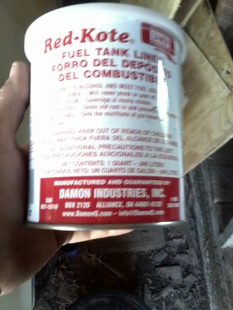

From what I have been reading, it seems the Auxillary tank is no longer available and can be hard to find. I have cleaned many fuel tanks. From my experience on other tanks what most people think is rust on the inside of the tank is actually a chemical build up from all the additives from the gas companies.
I pull my fuel tanks and fill them with white vinegar and let them soak for up to a week or so and then flush them out real well. Normally what looked like rust in the tank, when the vinegar is finished, will be nice clean metal with no pitting from rust. I have seen some bad tanks and vinegar made them look like new. Rust on a tank is a different issue where mud has gotten on top of a tank and rotted thru. To check for actual rust, I poke on the tank with a screw driver to see it is rust.
When done with cleaning a tank, I seal it with Red-Kote and it will seal up some pin holes if there are any.

So do you put the Red kote inside the tank?
Old Nov 13, 2016 | 03:24 AM
Terrys67's Avatar
Terrys67
Joined: Jul 2016
Posts: 128
From: Anderson Mo
Hello good to doo...You coat the inside of the tank with it. It is like pouring pancake syrup in it as it is thick. I have not done a Ford truck tank yet and not sure how well you can see inside the tank to make sure you get complete coverage. I have done several other tanks.
It says you can just coat over the build up in the tank and seal it away from the fuel. In some cases, when you see a tank it will look like rust. What it actually is, is a build of the fuel additives. It can get up to 1/4 inch deep and it will have veins that look like the veins in a tree leaf.
The sides of the tank will have flakes like fish scale on the sides. Every tank I have ever cleaned has always come out looking like new steel when using white vinegar. There are other products that you can use to clean tanks but I just use vinegar.
It can take a while to clean the tank which is why on a project it is usually one of the first things I do. When I get the tank cleaned, I then let it dry, usually with a hair dryer or a low heat gun and you will have red dust left in the tank. You can try to blow the dust out but it is hard to get all of the dust out. I learned to use a vacuum cleaner to get the dust out. The dust is going to be like baking flour.
Red Kote says it can seal up pin holes. I have not cleaned a tank yet that had pin holes in it. I have scrapped some tanks from mud on top of the tank and it rusted big holes thru the top. Before cleaning a tank, I take a screw driver and tap around the tank and see if it will push thru. A tank should be able to take a fair amount of pressure with out the screw driver breaking thru. I really like the Red Kote. I have two tanks and not sure the condition of them. If I could afford new tanks, I would go that route but some tanks may not be available.
I get my Red Kote at Oriellys and sure other part stores can order it. Usually the stores will not have it in the customer area but have a can in the back area. You will need to ask a sales clerk if they have it in stock or they can order it in usually over night.
