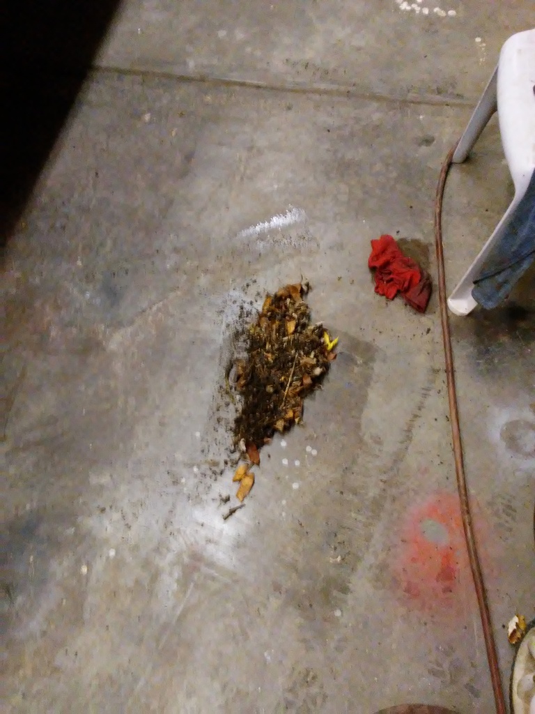

I tried to use the air gun to blow out the debris from the cowl. That got some but not all of it. It kept moving to the front instead of to the drain hole. On the passenger side it was half full of debris.
Some of what was in the cowl in front of the windshield.
What was in the passenger side. I finally got it all out when I took and flushed it out with a water hose.

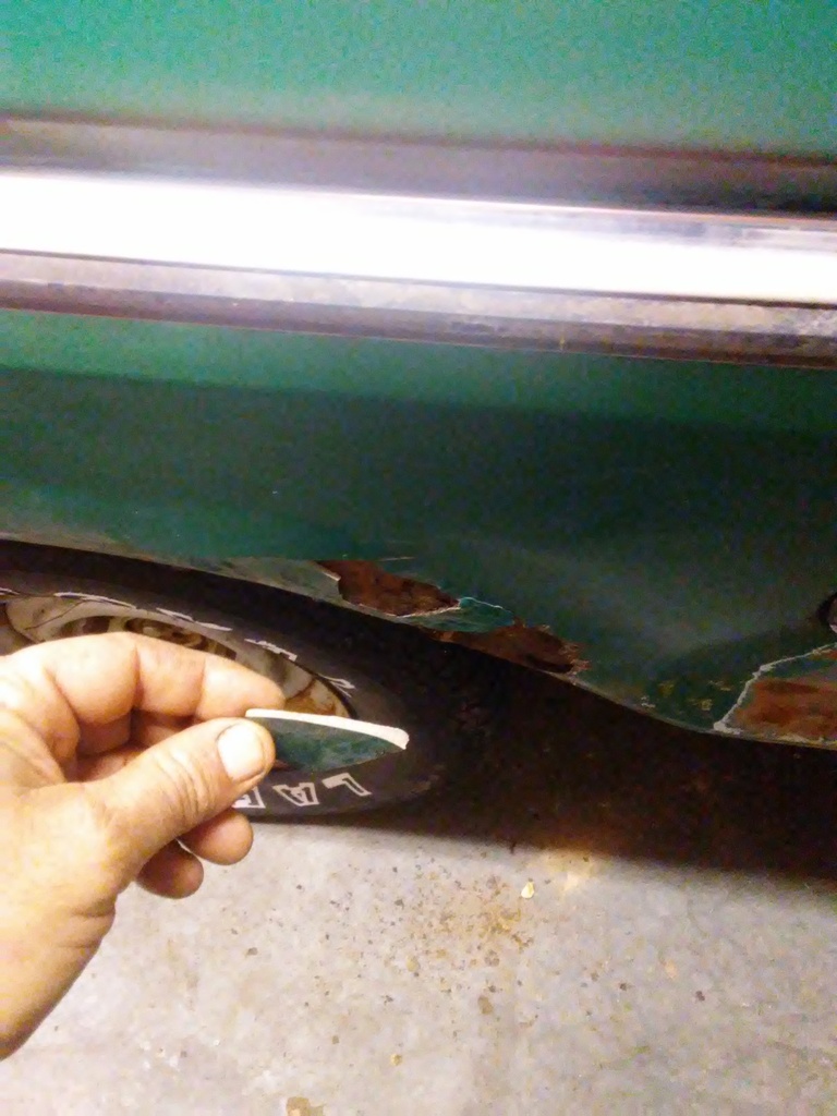

While out in the shop, I was looking at the truck from an angle. All in all the truck is in great shape for around here. Most trucks had a hard life in my area as they got worked. You cant see the dings it from the side, but looking at an angle, you can see several door dings. My guess is a previous owner was always parking to close to gas pumps or front row parking. I always park way out in parking lots just to avoid dings.
Dings I found in the door.
Probably at one time there was not much rust on the rear wheel well but when this truck was repainted, they put body filler over it and probably made the rust much worse. I will replace it with some patch panels when I get to the body work stage.
