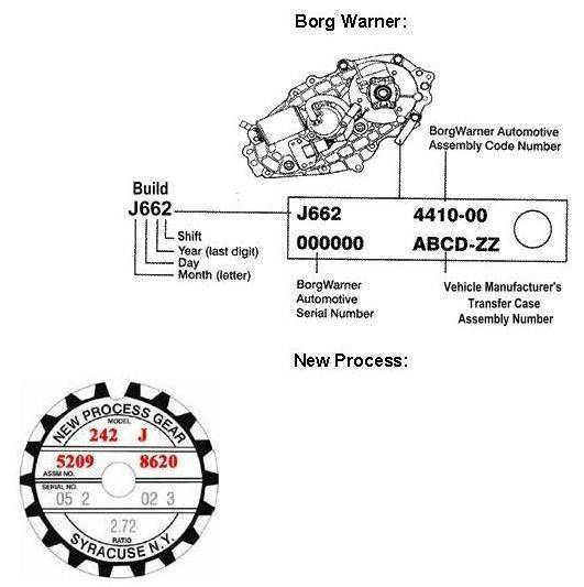

OK thanks, what is that diagram you attached for? I mean I know its the transfer case, but whats all the other stuff outside of the case?
You can find any part or information using the nomenclature found on your Transfer case. They're not Ford Specific. They're used in just about all Domestic 4x4 Applications and Manufactured by BW.
