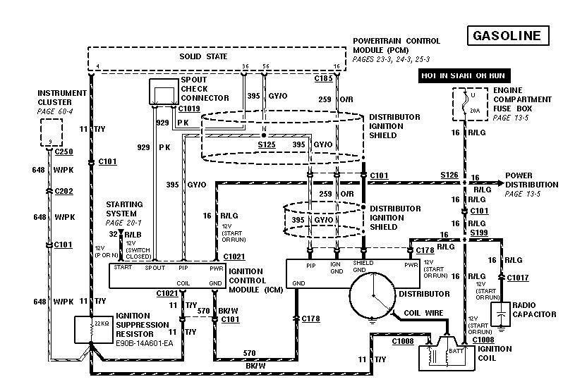

Ford switched from Push-Start ignition to CCD in 1994, there are wiring and computer differences involved in that change. Ford then moved the transmission solenoid protection diodes from the transmission to the computer (PCM) in 1995.
Since the OP has a 1993 MY truck the best bet is a 1993 Lightning PCM. I agree the base programming is pretty much the same but there are other items coming into play here.
1993 and earlier Push-Start Ignition:
1994 and later CCD Ignition:
[IMG]https://cimg2.ibsrv.net/gimg/www.ford-trucks.com-vbulletin/1115x595/80-1994_ccd_ignition_c1ecb646e7eae3f47f920cbafea005fc 92f0d590.jpg[/jIMG]
so I can use the 93 lightning ecm?

IMHO your best bet is a 1993 Lightning PCM. You know it was designed to work with the Push-Start ignition system.
