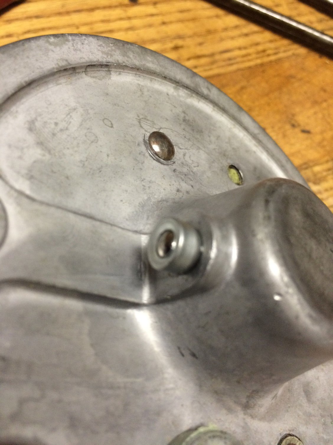

I am taking a 2nd attempt at restoring our 226 generator, getting it close to new condition. I picked up a NOS end plate. Is this what the original oil cup looked like?

All the ones I've seen have a spring-loaded cap.
If you're going to the trouble of replacing it, why not go to the later Y-block style that has a ball bearing? I may have one.

If memory serves me right, the original had spring loaded covers. Been a few years.

I have a spring cap but it doesn't fit over the cap in it. That cap you see in the picture has a ball bearing on it.

I think it's just a newer style maybe as I can find them online also, it's a ball bearing oiler. Depress the ball with a wire and oil it. Interesting....

I believe that is a type that you press the tip of a hand pump oiler against the ball to depress it, then the oil can be pumped. The snap cap is better at keeping dirt out, I'd guess
