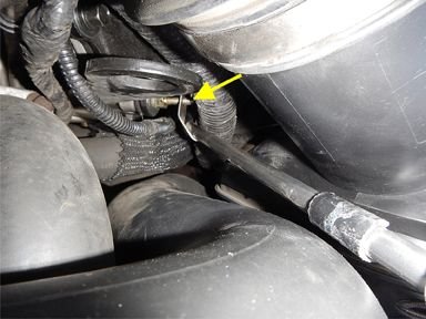

Unessary Repairs continued
As I said, I haven't looked at the truck since I got it back, other than to hook up my battery tender. I took a short tour around the engine compartment also today and found a couple things.
Yep that is an unsecured Injector harness cable right up against the serpentine belt...
That is the dip stick attachment not bolted down. I actually put it on the stud as it was just hanging unattached.
Honest to God, I am afraid to snoop any further... Remember. he had all the injectors out...

SABOTAGE!!! I am just wondering what else he did!
