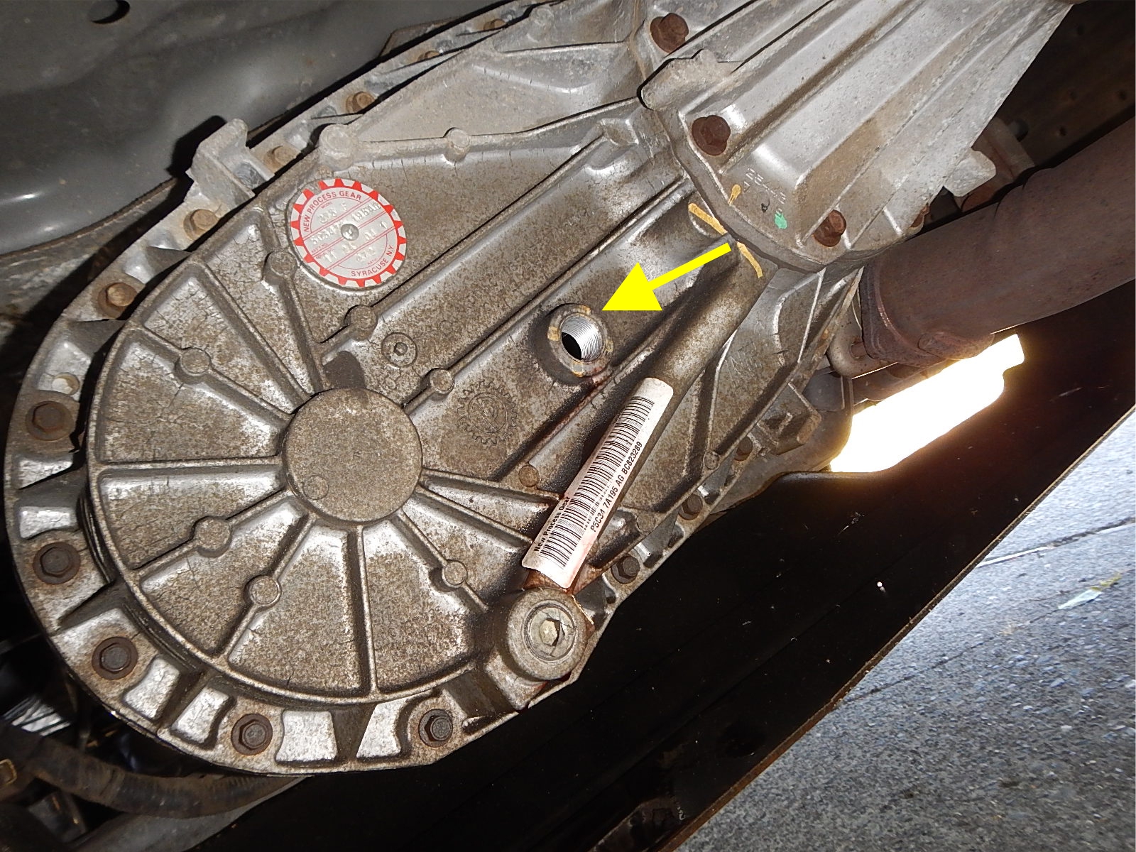

Unessary Repairs
Figured out why the transmission leak... Before someone says why didn't you look when you got it back? Well, I was so discussed and didn't have the money to fix it if I found out what was wrong, I just parked it at my house and tried not to think about it...
My brother finally came over and crawled under it and found the missing filler plug... Does anyone happen to know the size? Do I HAVE to get it from Ford? Name:  Missing filler plug 2.jpg
