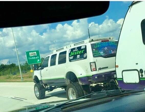

I'd love to have a Dually Ex for a dedicated tow vehicle.
Are you going to get the from axle from the donner vehicle ?

If I'm gonna dream I may as well go big
Six door dually.

Weak, go all out. Local builder makes these things. Started life as an Excursion and evolved from there. Megacab dally flares make for a pretty damn clean look IMO, haven't liked any of the other flares on dully Excursion conversions.
