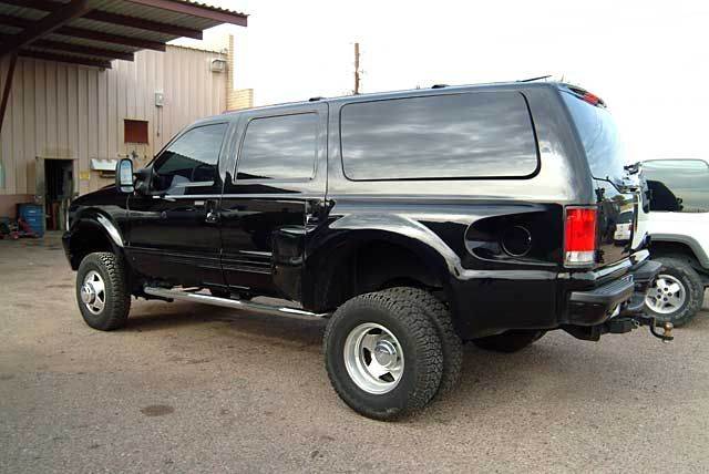

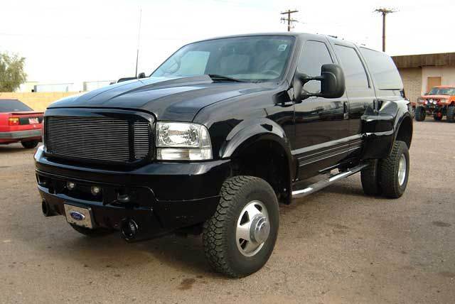

I ran a quick search on Google, and to me every single one looks hideous. I hadn't even thought about the rear door handles or fuel filler neck, and the work around solutions lend a very unsightly fender profile IMHO.
I wonder if running a narrower rear wheel would work with some of those Icelandic expedition fender flares to maintain a smoother fender transition? Granted those flares require extensively more body work, but I think the end result would be far more appealing plus allow for larger tires without as high of a lift (low CoG for the win).
In order to be able to rotate the tires, the front wheels would need to match the width profile out back as well. On aftermarket wheels, you don't rotate the wheels - you rotate the tires instead. I remember loathing dually owners that would come in 15 minutes before closing when I worked at Discount tire back in the day. Break down all six, rotate the rubber, remount and inflate (which took forEVER), and rebalance. Ugh. The stock steel wheel rigs were so much easier as those were just pulling off wheels and rotating the assemblies.

Originally Posted by Krazee Matt
I actually like this look. see how the gas door is flush with the fender vice being recessed.
seemed like a stupid idea at first, but I can see where this would be a great tow rig for larger tows
