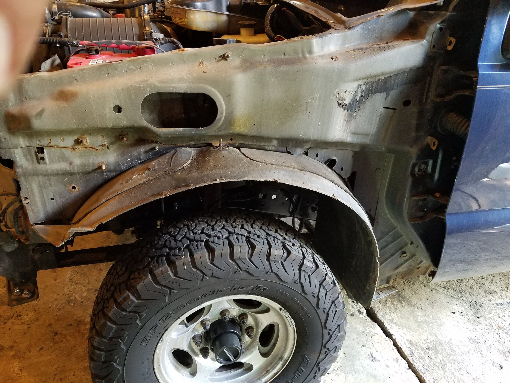

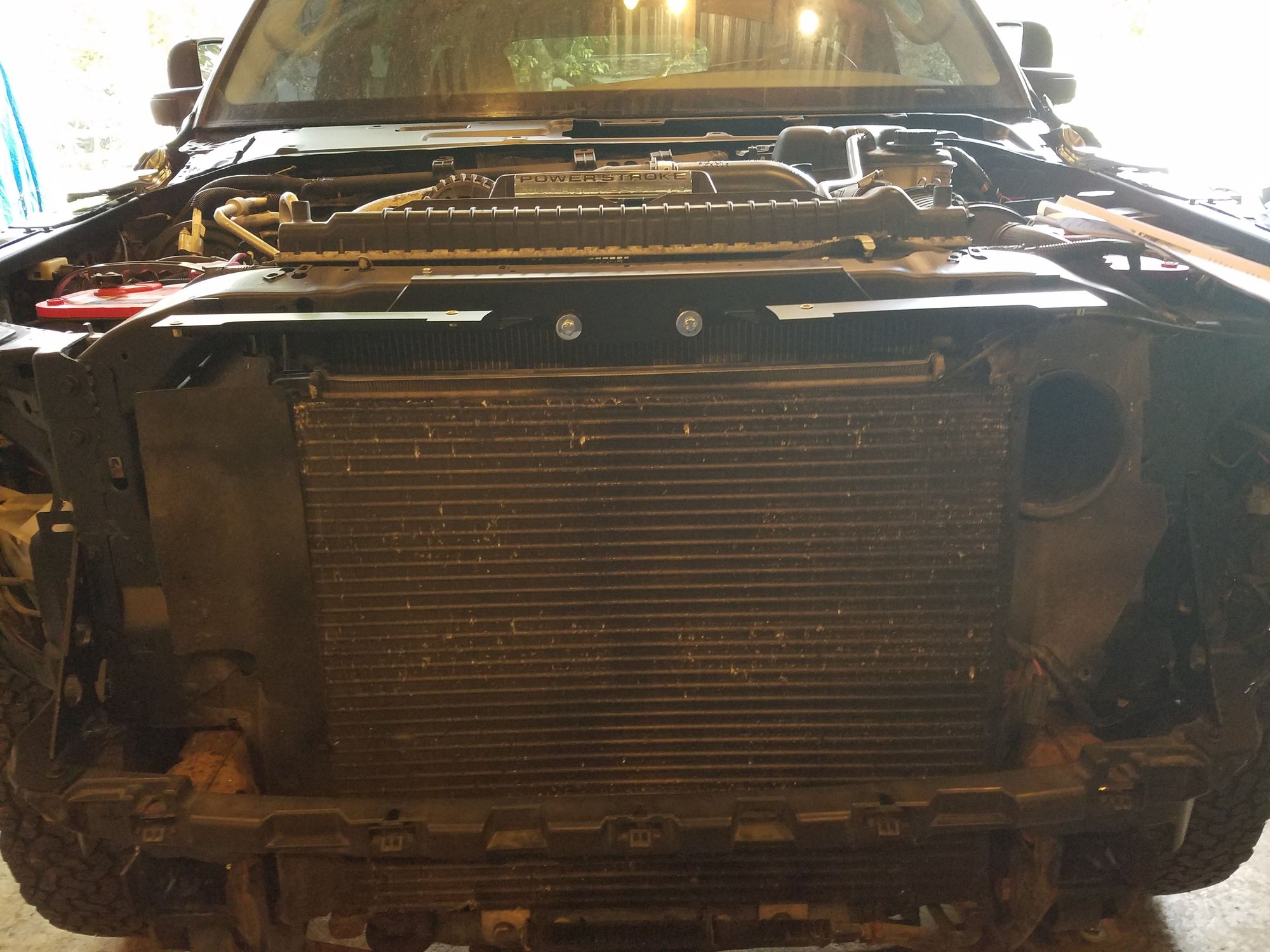

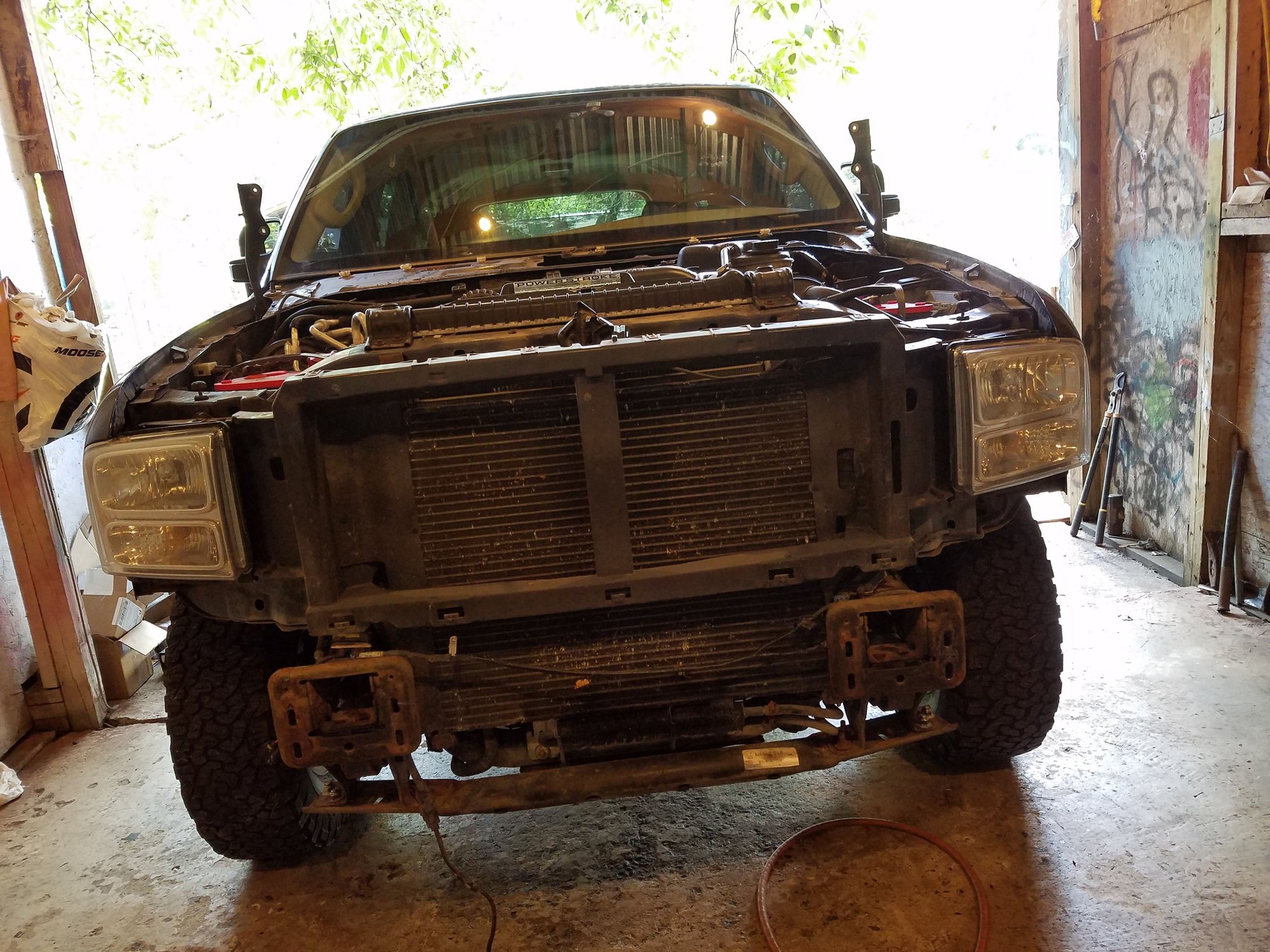

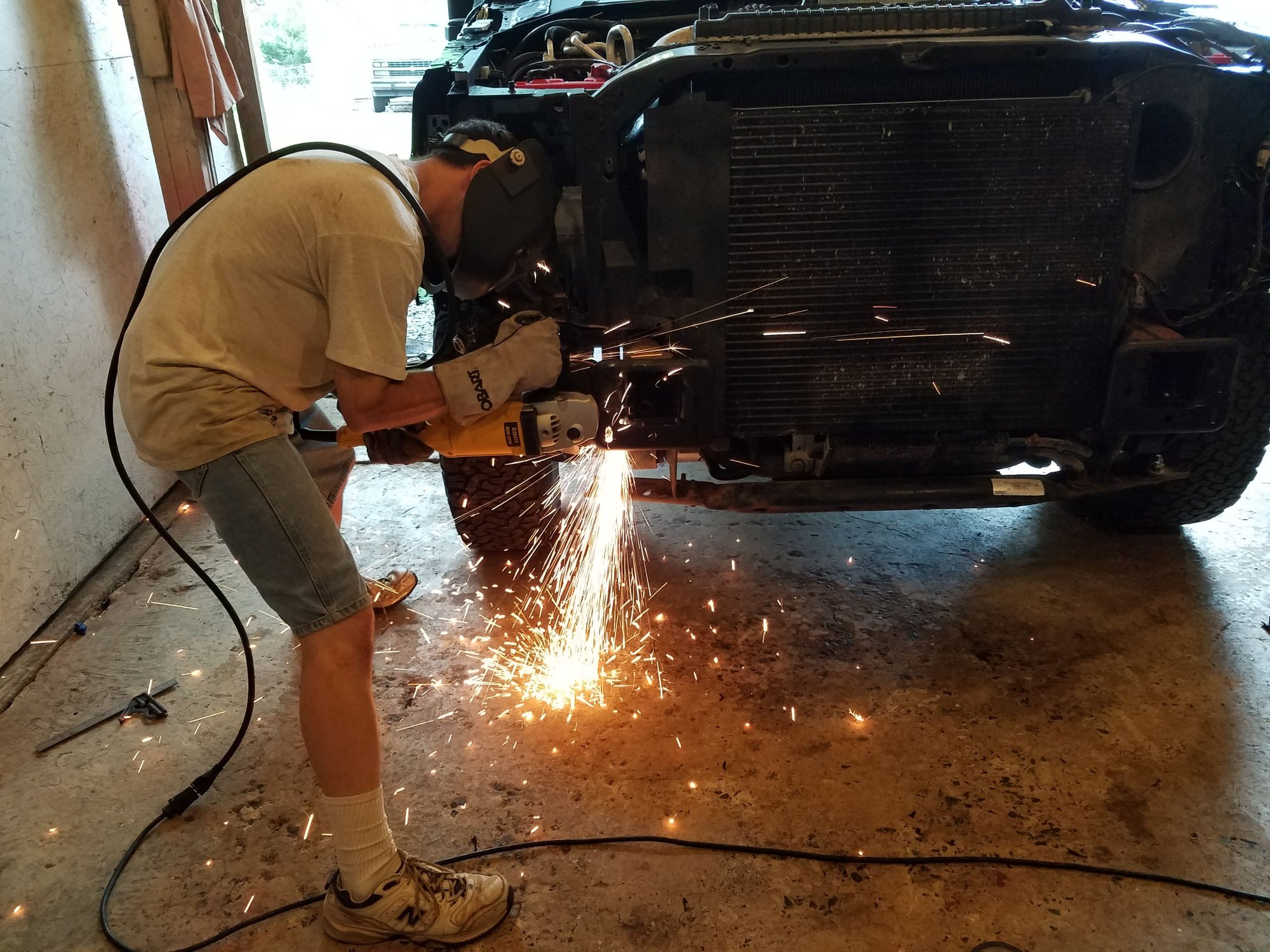

Today marked my first day of the 2011 front end conversion build on my Excursion. Unfortunately, I do not believe I will be able to finish the build while I'm home for the next few days, but my brother has enlisted his self since he knew I was going to need help anyways and loves a challenge. I told him to document his every move to help the next person and for myself. During my travels, I have collected alot of the parts from Craigslist, my goldmine junkyard, ford wholesalers, and the ford dealerships. To my amazement, just for asking for a discount, I was given 10% to a 20% discount. With that said, I have about $2500 in the build that includes all the parts for the 2011 conversion, McNasty kit, and a complete bed for the rear quarter panels. We tackled disassembling the entire front end and run into small areas of rust, and we decided that it was a good stopping point to fix the problem areas. I thought I was going to be able to use my hood stops and hood struts bolts, but was so rusted, we broke them. So now I can say that the entire front end is "newish". Tomorrow, my brother will start on the cutting and modding, and hopefully I will be able to help him install the hood before I hit the road on Wednesday. Once we complete the front conversion, we will take a break for me to drive the Ex to the outer banks for a wedding in September and then we will start on the rear panels. After its total complete excluding paint, I will start slowly modding/doing the preventive mods on the engine, lift, and wheels & tires. I hope everyone enjoys.

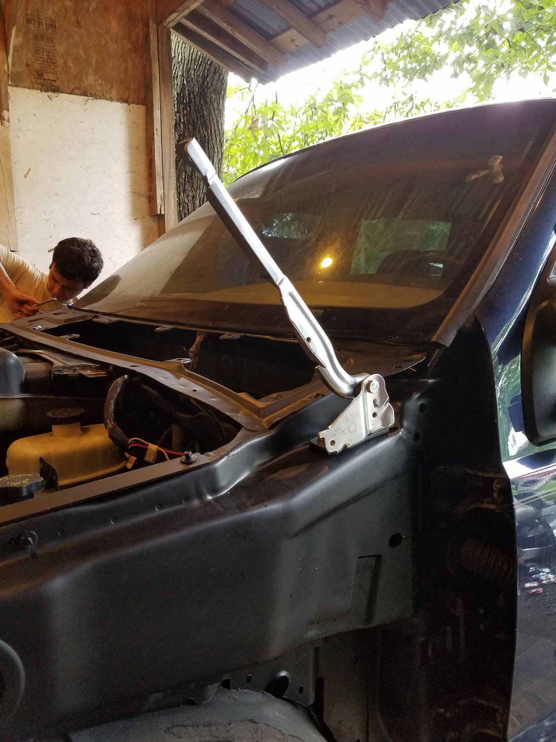

Today, my brother maded all the cuts today and we start putting it together. I'm going to need to pick your brain when we start the rear fenders.

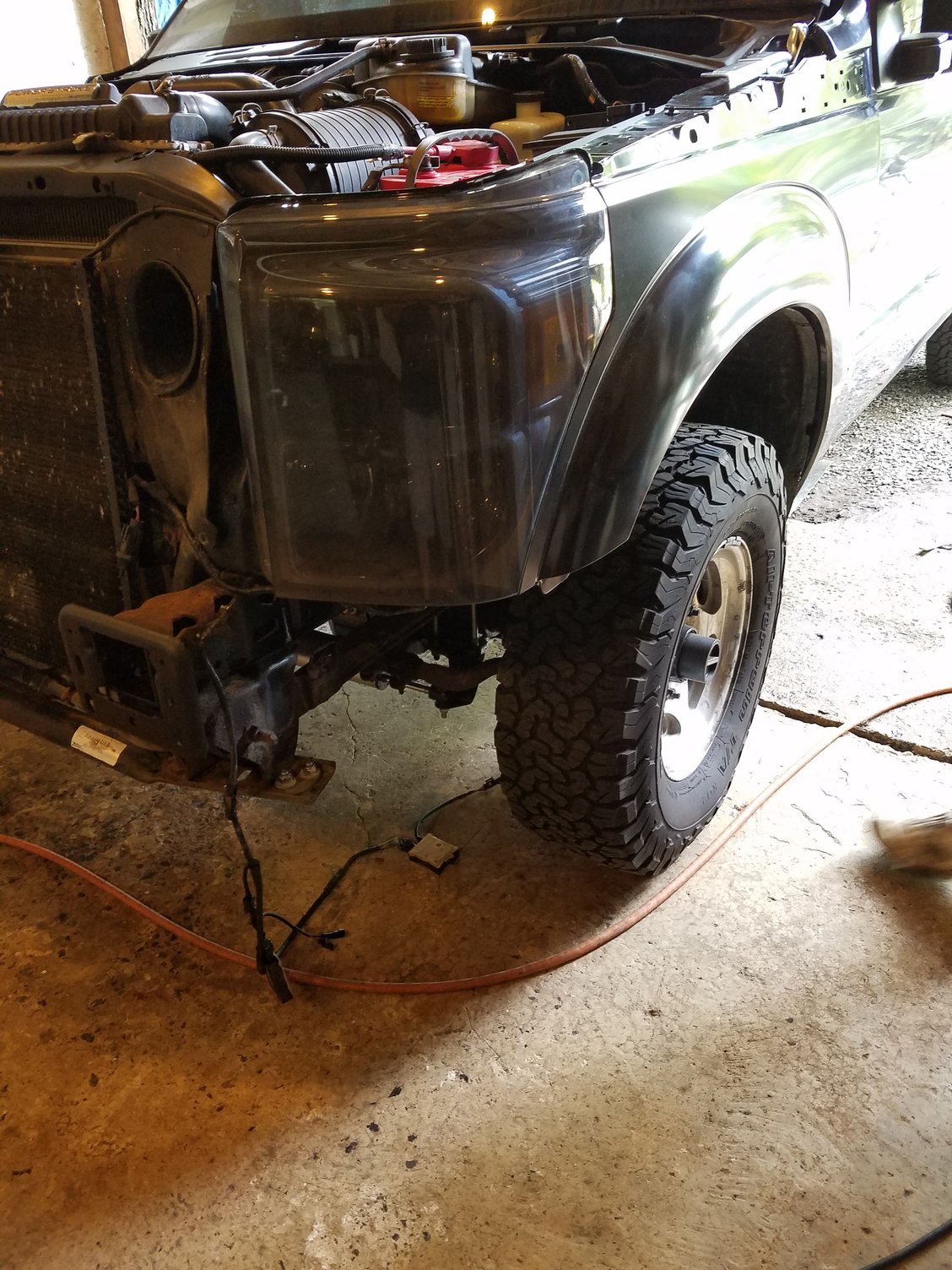

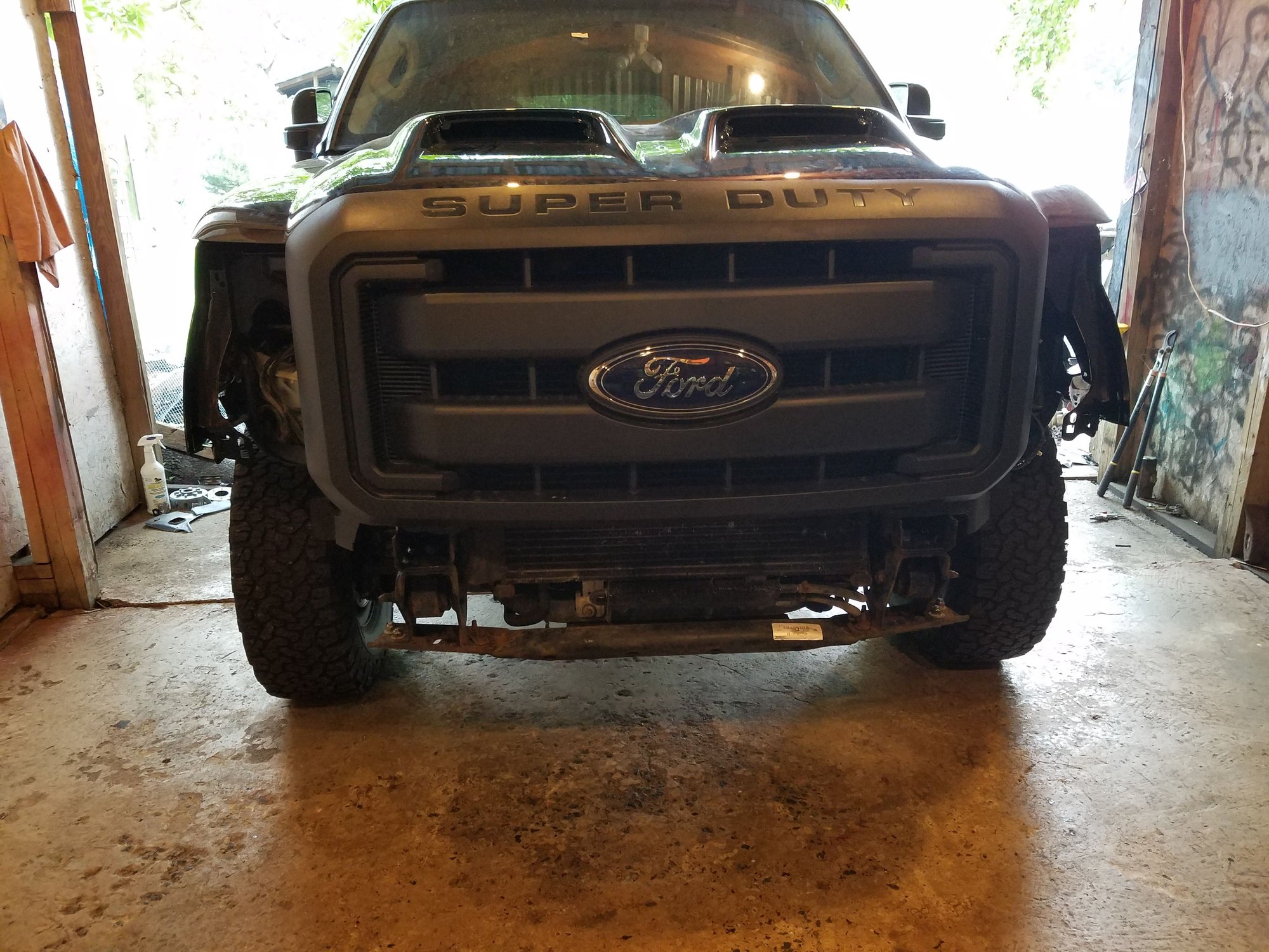

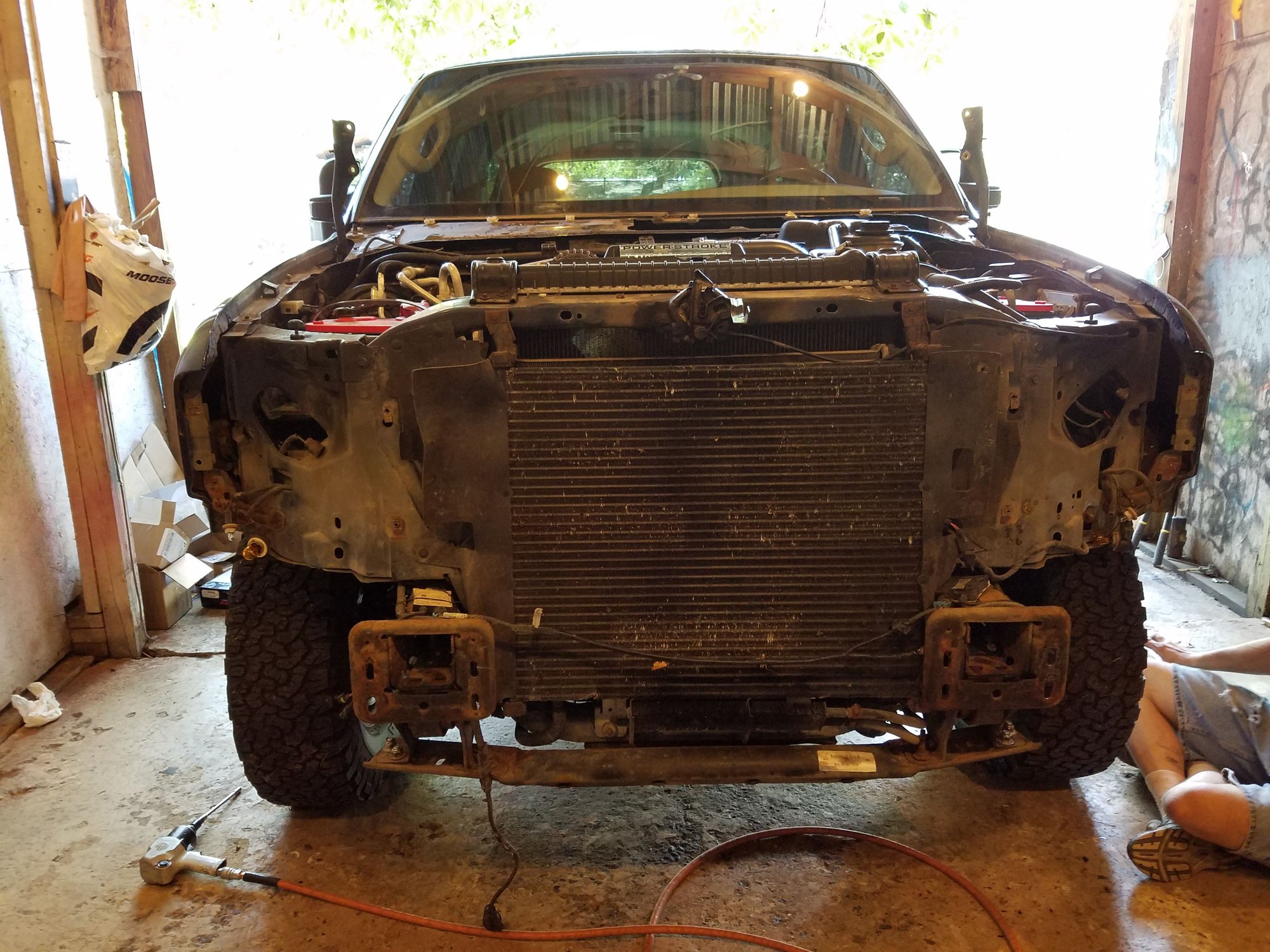

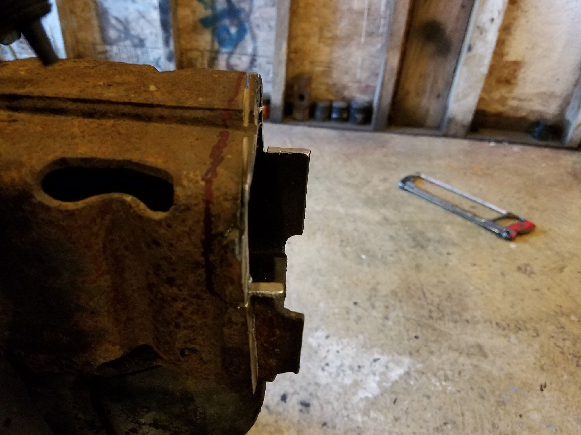

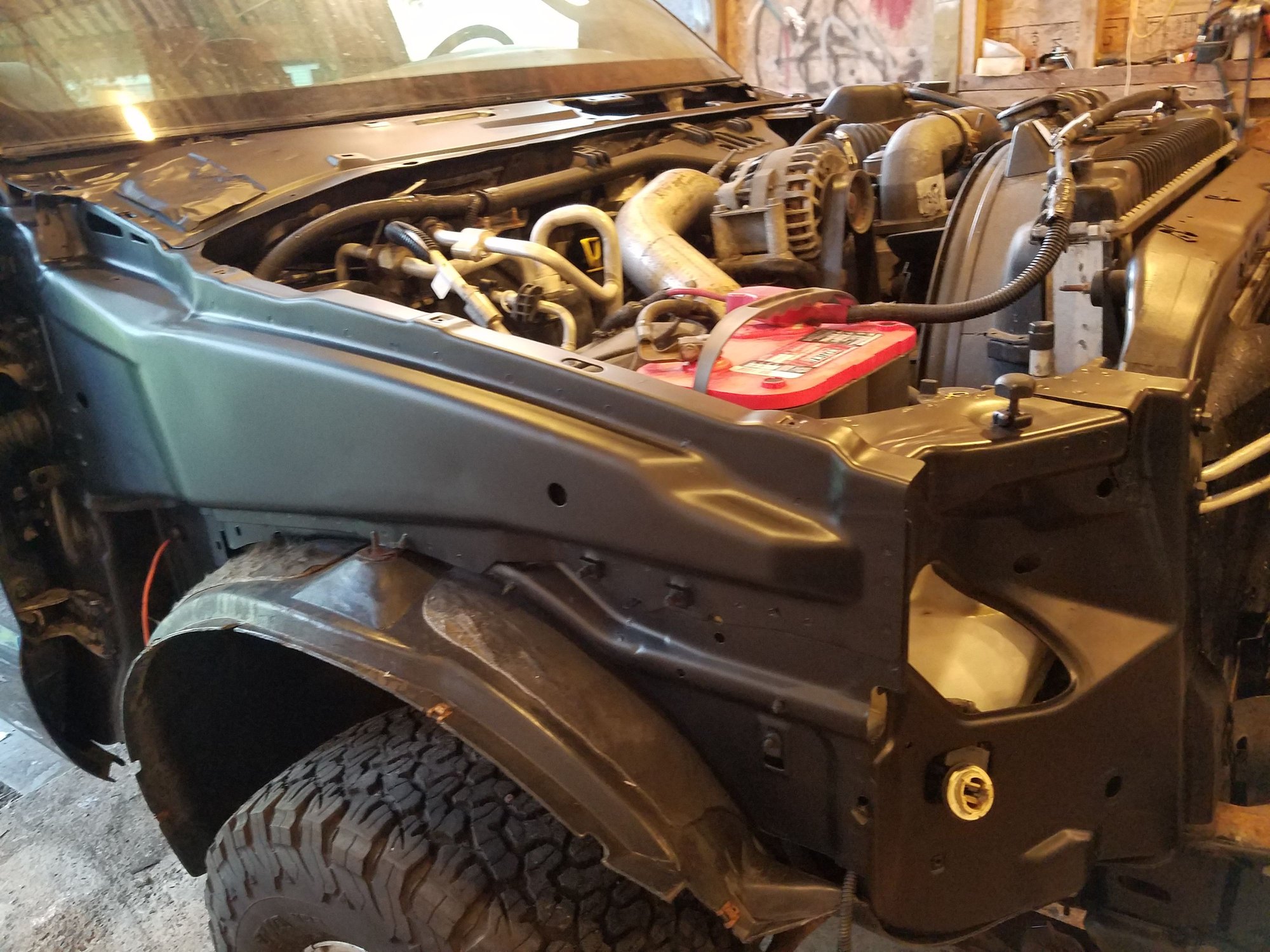

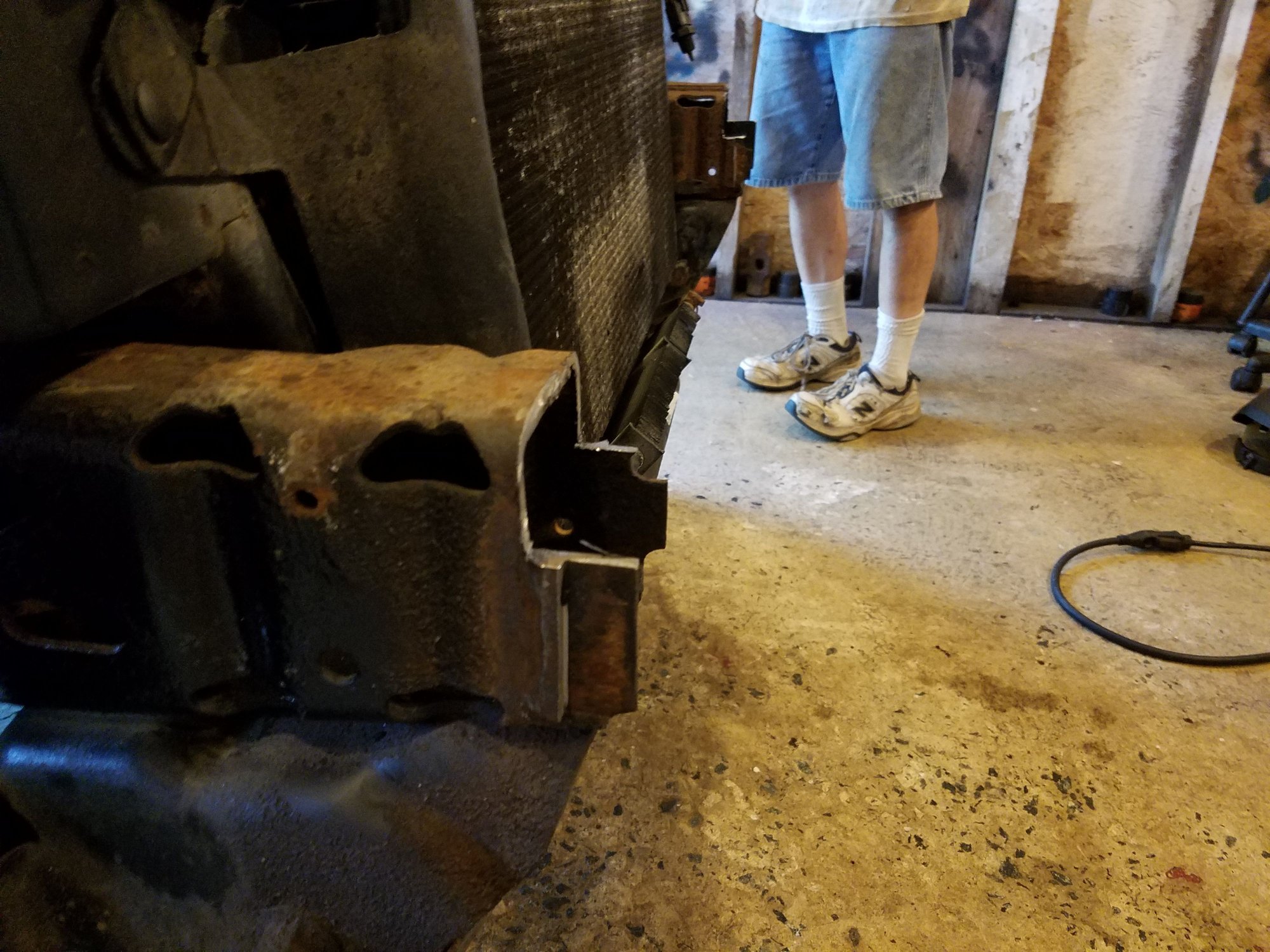

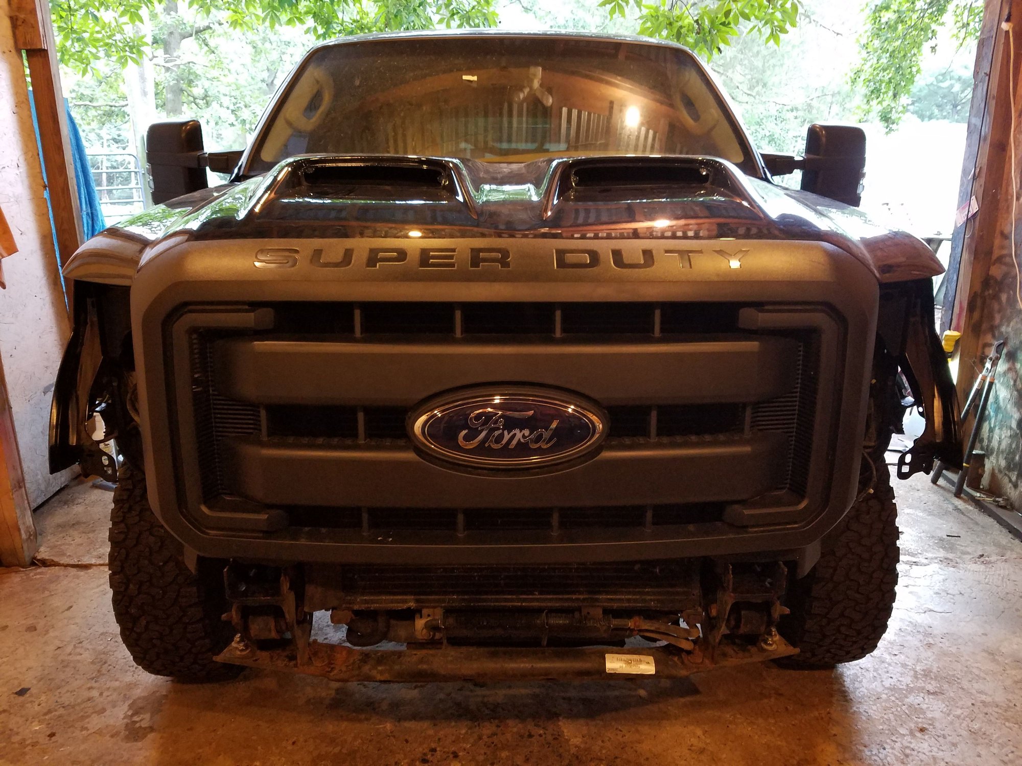

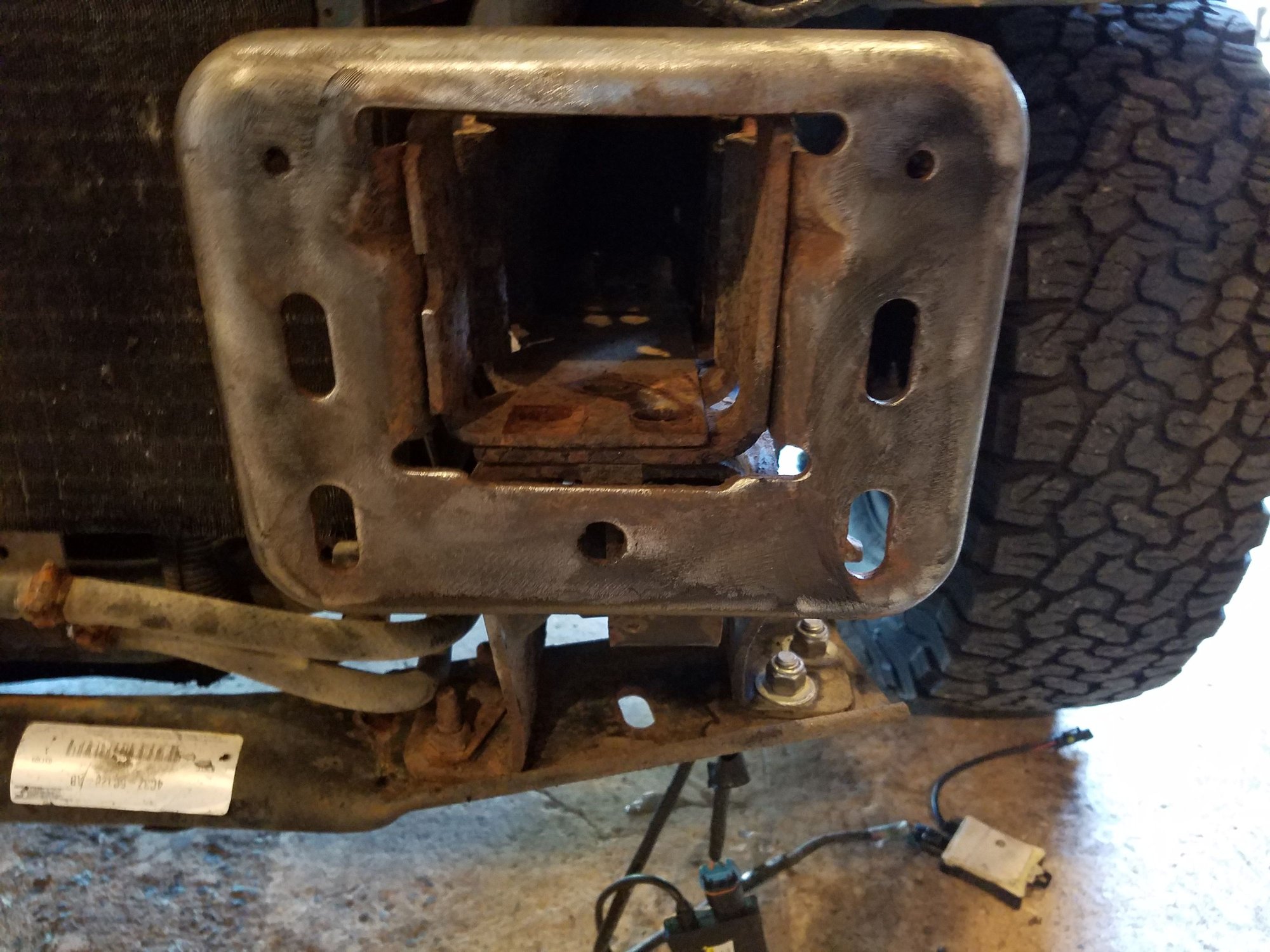

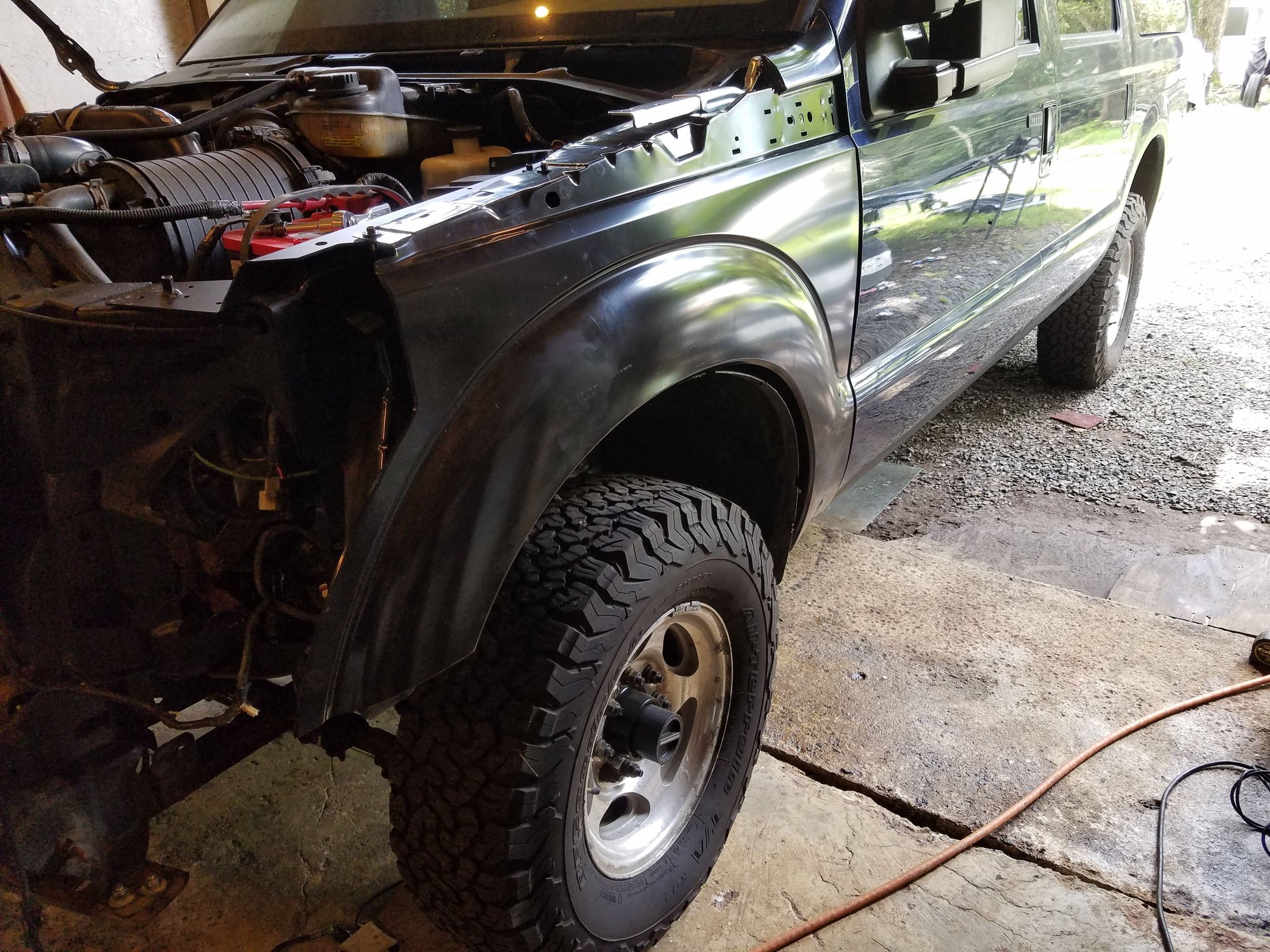

So the cutting and modding wasn't completely finshed yesterday. We got a late start cutting the frame horns and lower header panel. Mounted the fender and realize we will need to weld a bolt below the A arm to secure the fender, as the fender actually bolts. The McNasty kit wants you to use a rivet, but I'll feel better welding a bolt on. The pictures with the black around the fenders and along the bottom is where I got a little excited with the prime. I thought the prime looked better than rust.

Tomorrow we plan to fab the bumper mounts and do a little welding and cutting.
