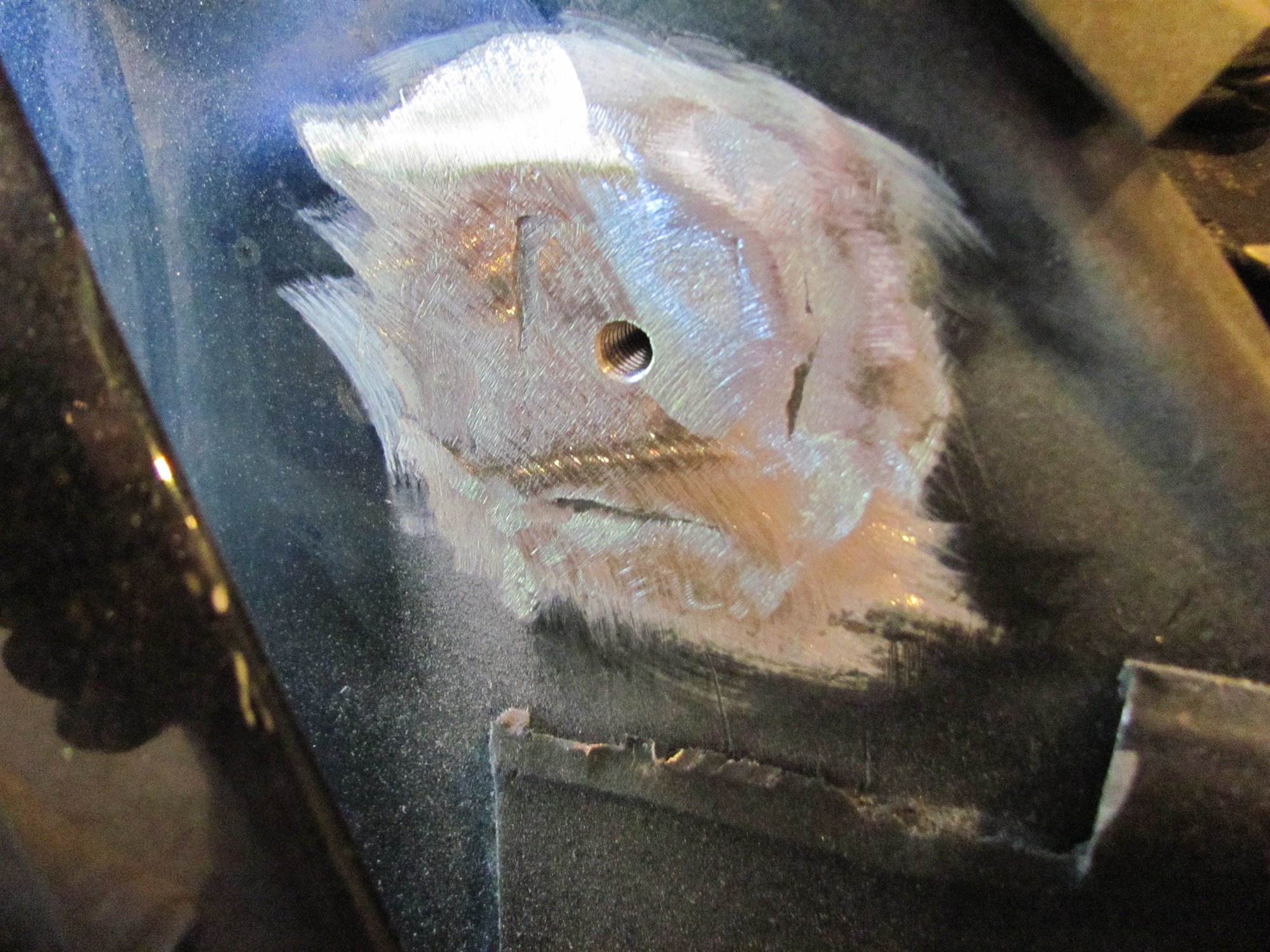

This is where the bumper mount on the frame was cut off and welded back.
The 2011+ F250 fenders bolts near the bottom of the pillars and we welded a block of metal and threaded it, so that the fenders are extremely sturdy.

Thanks. The hardest part was collecting the parts, as I started at the beginning of this year. Then it was the speed bumps, when we had to get creative to make it secure. I took it for a road test yesterday and everything stayed on the Ex. I purchased a kit from McNasty Customz which made it easier to put together, but I realized that it not 100% bolt on and alittle more cutting/welding was needed.
