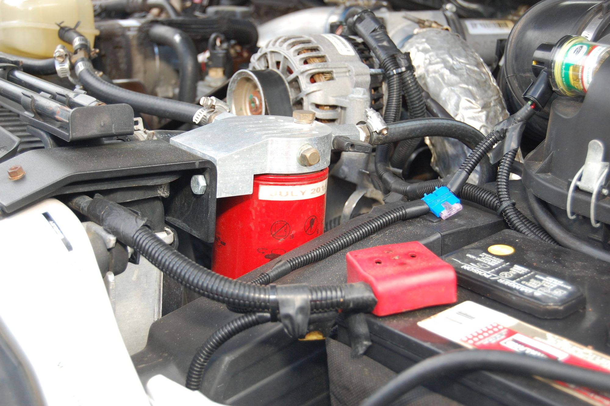

How many of you installed the coolant filtration system on your 7.3. If so which one and do you feel it's necessary. I'm contemplating on installing one.

I believe it was from Dieselite? I did this 10 years ago. I have opened the filter and found some sand in maybe the first two changes. But very little, if any, after that. I change the filter annually.

Went with the International water pump with spin on filter. Needed a water pump any way and the additional expense was about the same as parts for a diy or kit. Tarm and then Nicmike did a good write up on the swap. Swapped to ELC at the same time. https://www.ford-trucks.com/forums/1...er-pump-3.html
At about 10K I cut my filter open expecting to find some sand or something and was pleased to find nothing, nada, zilch. Looking back I could have just done the ELC flush and change over.
To answer your last question unless you have an e99 and have to run SCA coolant, think you have a motor that sat a long time or have a cooling system that has been neglected I don't think you need one.

Same experience here, I had the Diesel Site kit and running the OE Ford gold coolant, no debris in two filter changes. Removed kit.
If you run the green coolant it's a great idea, but ELC or gold, not needed.

I also have the DieselSite coolant filter I change the filter once a year I also get it flushed every 3 years for $80 it's not worth my time personally to flush it I also run RMI 25 in the coolant instead the ford additive 250k miles knock on wood no problems went through one water pump at 50k. I do like the international setup Diesel Site has though with filter on the pump might go to that option if I lose another pump.
