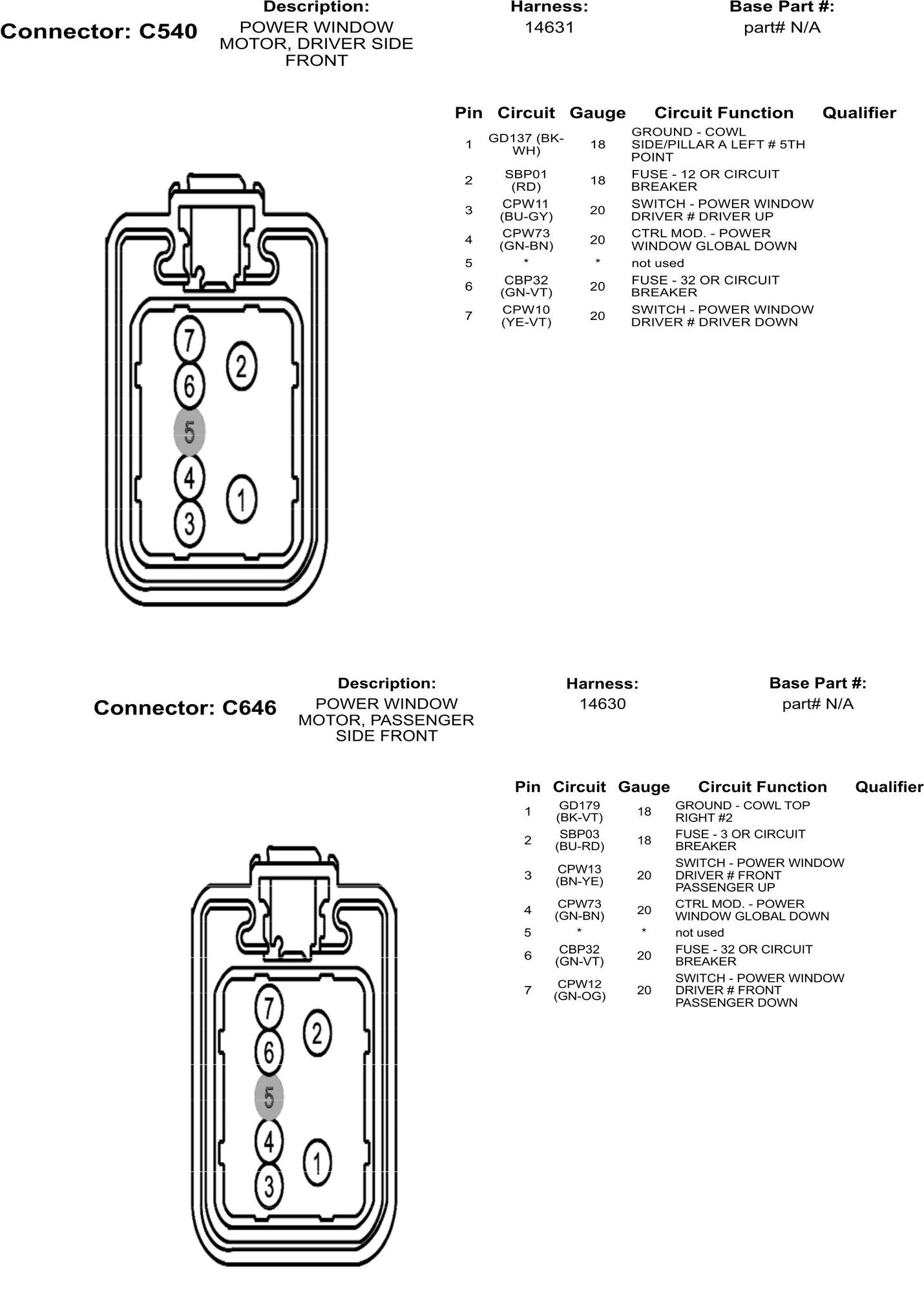

I'm working on some issues with a window motor. The plug has 2 large pins and 5 small pins on the motor itself. Does anyone have a schematic or diagram of what these pins do?

I suspect this 2015 photo I made for you from the Ford Service DVD (yes, from Ford) will be the same as your 2014.
Sounds like Dealer Service Rep didn't want to take time to help you.

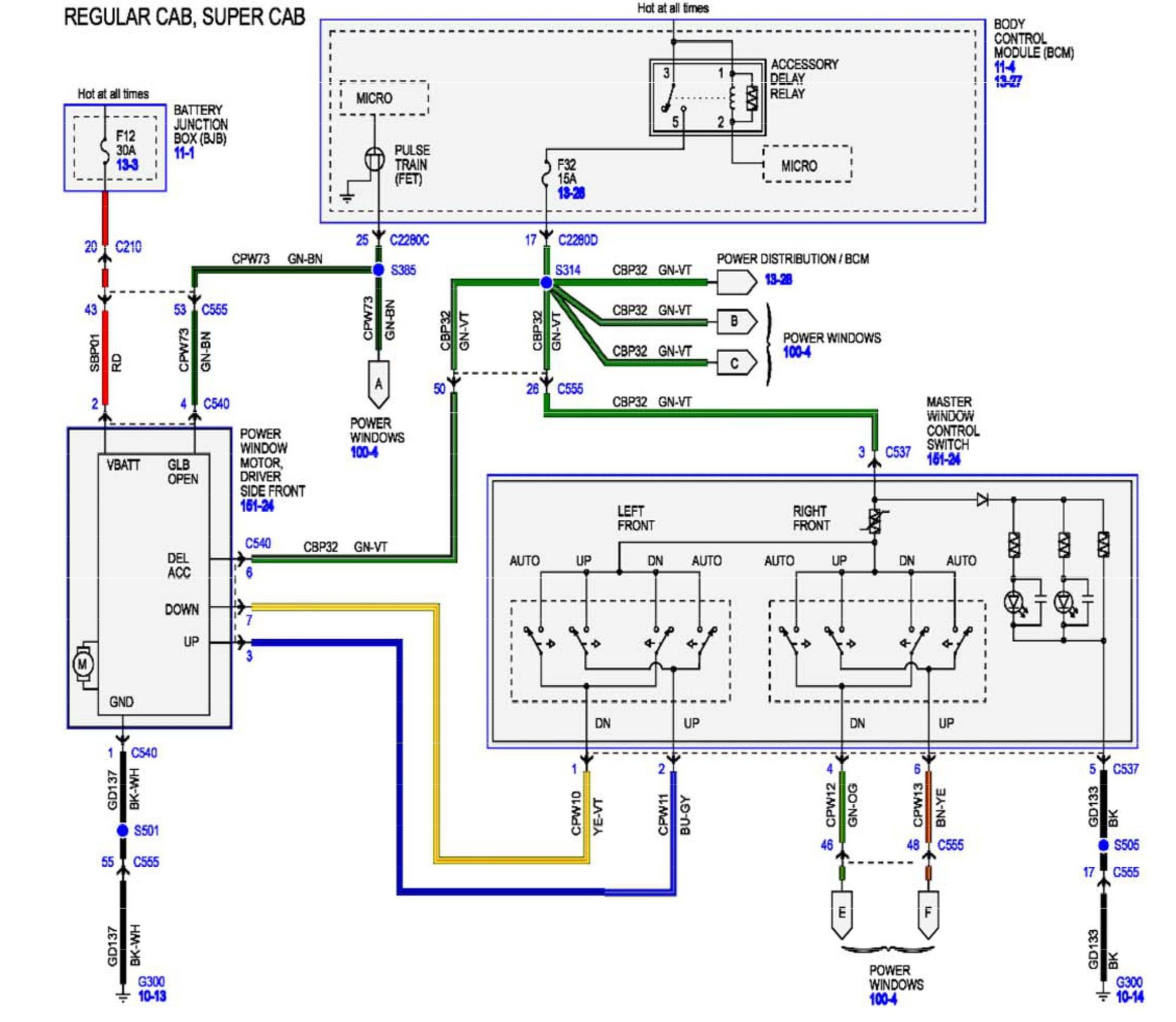

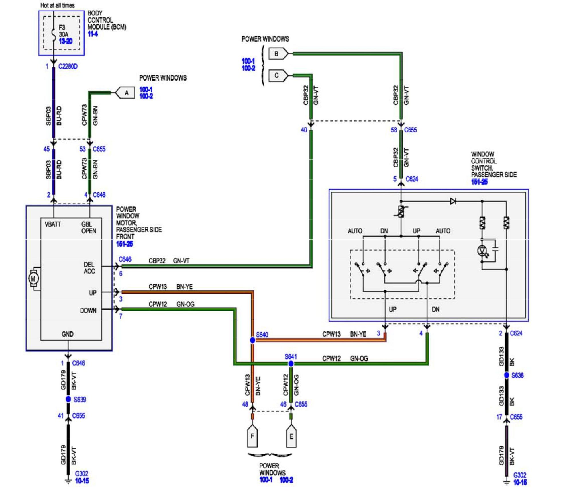

schematics
Driver Door
Passenger Door
