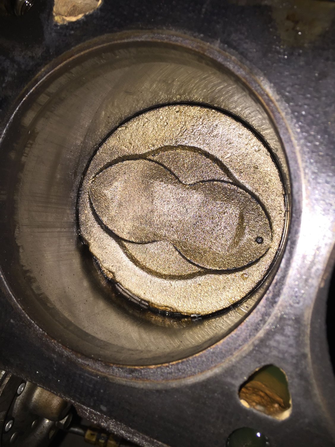

Any ideas what caused this? I didnt see any parts or pieces when I took the head off. It looks corroded?
Poor metallurgy and/or lean AFR.

That one (#3) I was at 80 on a compression test. The lifters were seized up, come to think of it.
The others are pretty carbonized but look fine.
While I have it open, I measured the stroke, 3 7/8ish. So I bought a 302, vin said 360, turns out 390.
