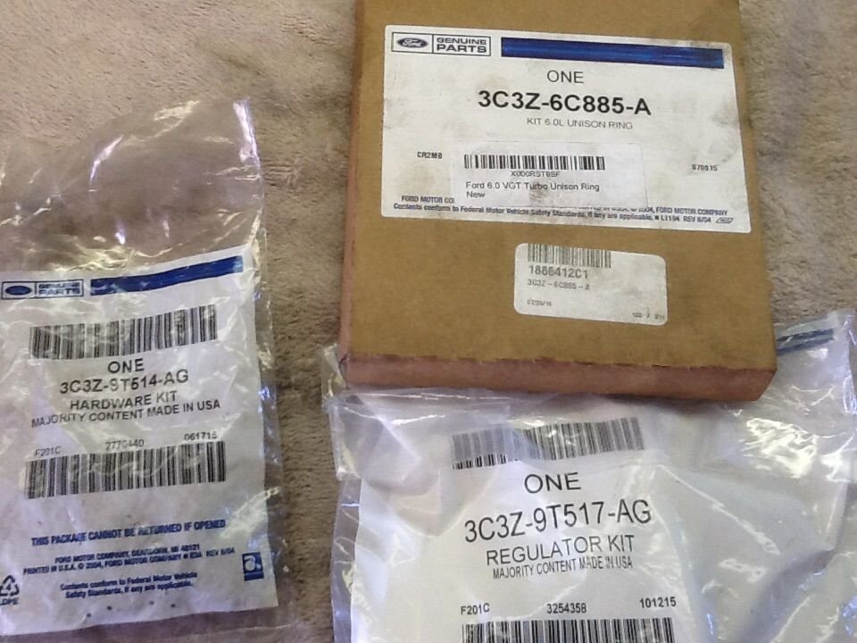

Once you remove the steel cap on the turbo with the hex head index in the middle, you can remove the snap ring and access the solenoid arm. It's oil driven so it can still move slowly, even when connected, if the unison ring is operating freely.
I've posted this picture before but you can order this online from Amazon or the like, avoiding that dealer.

Originally Posted by r2millers
I know he says it's an overboost condition and "maybe" a P0299 underboost but again, not sure it would spool up if it's a vacuum issue with the MAP, etc.
So where abouts is this steel cap on the turbo? And how is it removed? Is it the little grey looking thing under the VGT solenoid plug in? Thanks for your help.
