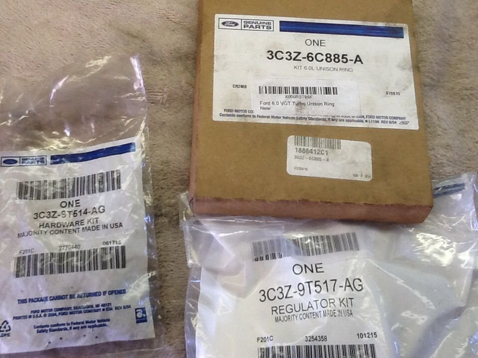

I had the same thing happen to me while towing. When heading up an incline, the wrench light came on, it also went into protection mode and I had to pull right over. I let it sit with the engine off for a minute and when starting, the wrench light was off and full power.
I did drive carefully home, only a few miles more.
It was the stuck unison ring on my turbo. P0299 code.
Buy an OEM new unison ring first before pulling it apart besides the o ring kit for re-installing. I reused my old unison ring the first time there was this issue and it lasted about 20k.
I really think the new unison ring has a slightly larger diameter to help avoid the same issue again. Can't be sure as I didn't measure before installing.
Here's the part numbers. I did add a Blue Spring at the same time, shown in the picture.

That hardware kit is 3c3z-st614-ag or 3c3z-8t614-ag?
I got it 3c3z-9T514-AG
