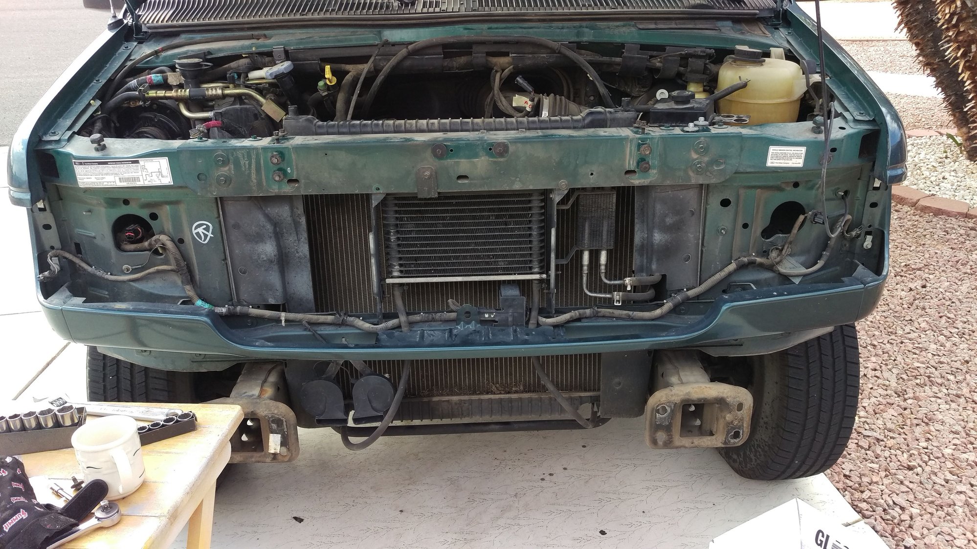

Pulled the bumper, grill, headlights and other shiny stuff yesterday.
Today I removed core supports with A/C condenser, radiator, shroud and fan clutch. Tied back disconnected electrical looms. I can now see the front to the broken engine.
I only have a couple of hours invested so far. I'm working a couple of hours a day in the morning so the job doesn't overwhelm me. I removed all the seats except the drivers to gain access when I remove the dog house. I should see the engine from the rear tomorrow.

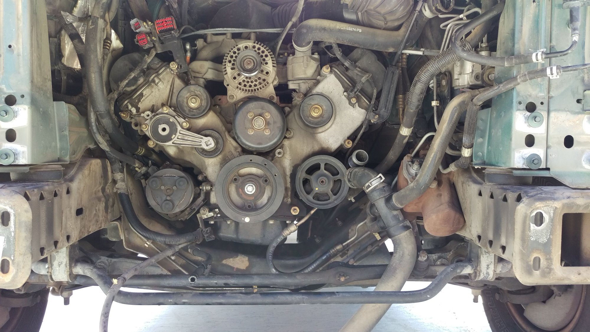

Pulled A/C compressor today and uncovered the hole in my V10 block. I have all the parts, maybe just glue them back in?
I'll bet that would work! Make sure you vacuum out all the bits inside the hole. haha
Looking good! Once all that extra stuff in front is gone, it really is easier to work on it. Good time to degrease and hose it all clean. jim

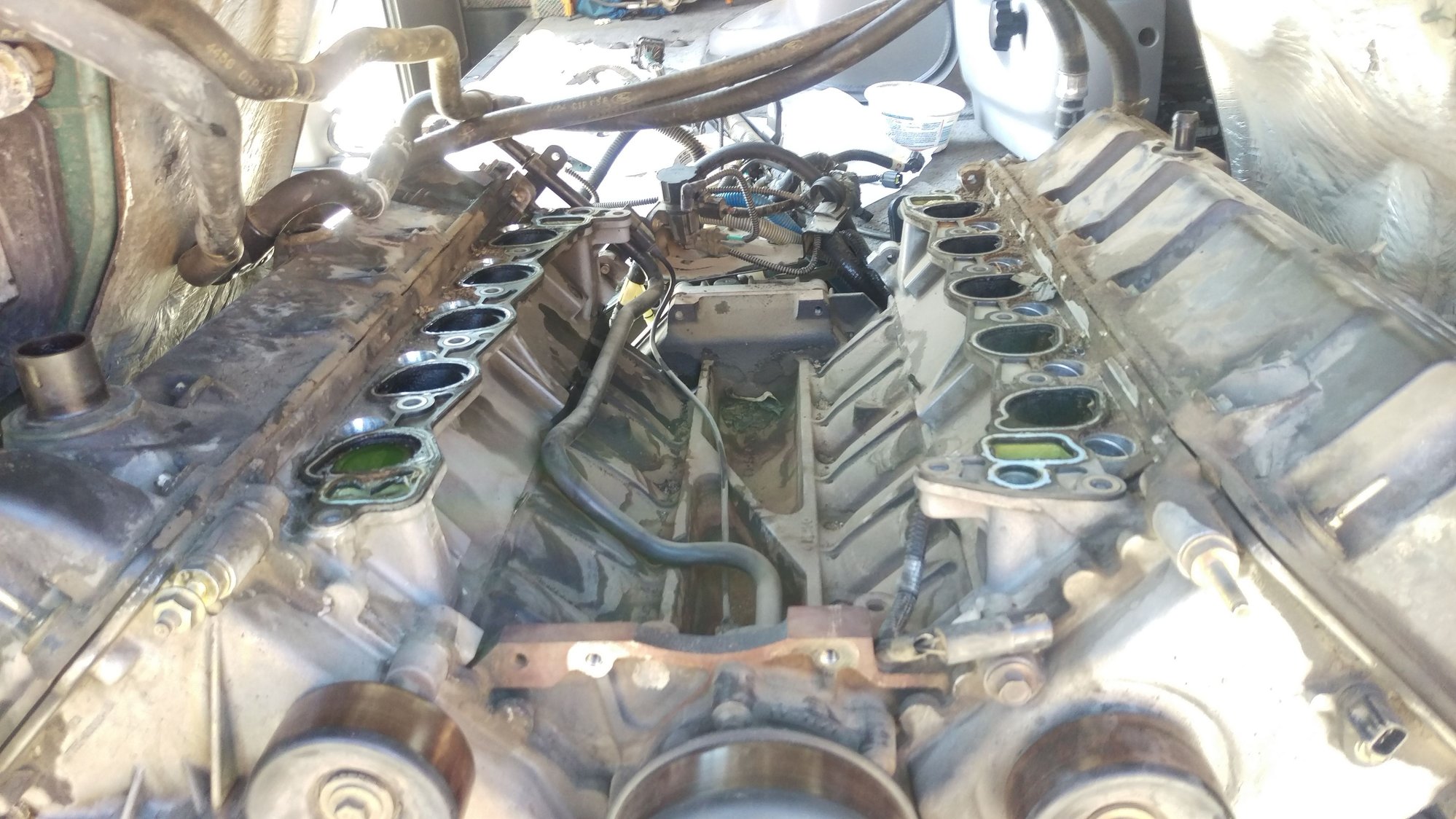

Got the intake manifold off today and there it was, Hydrostatic lock! Front intake runner on the passenger side is full of coolant.
Old May 3, 2016 | 01:48 PM
dcgayhart's Avatar
dcgayhart
Joined: Apr 2016
Posts: 170
From: Sun City West, AZ
Here is a close-up, you can see the damaged intake gasket between the intake runner and the coolant passage.
