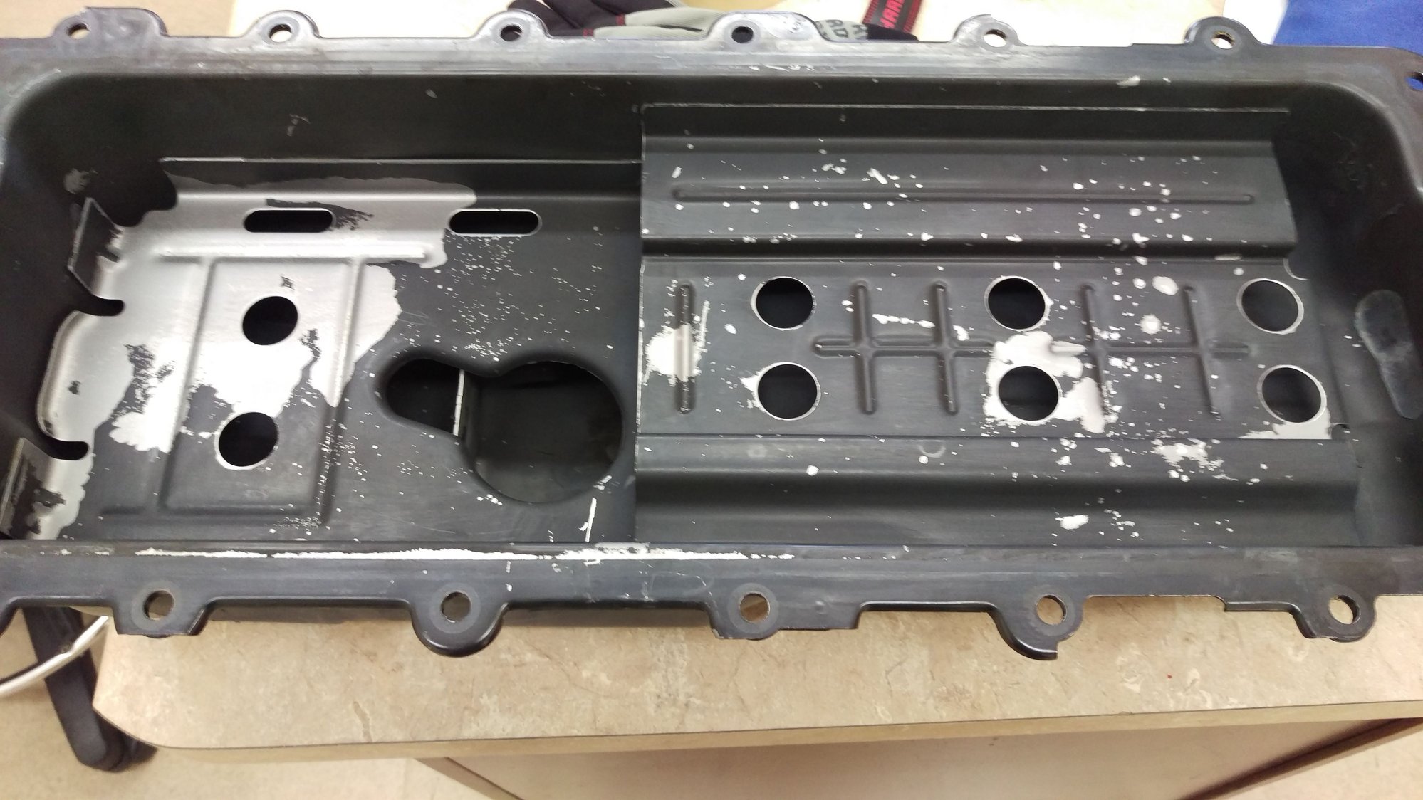

Oil pan was hot tanked over the weekend. There's a finish inside that has chipped off in places. I wire brushed and pressure washed it this morning and finish that is left is very tuff. Should I recoat the inside before assembly or leave it alone? If recoat with what?

is it a ceramic coating?
It may have been there to help the oil to flow off the pan
I can't imagine this making much difference on a street motor.

Just wondering if it will continue to chip off and clog the pickup filter?
That's the first thing I thought of.
I wouldn't use it. I'd get a new pan.

When I built racing engines in the 60's we painted the engine oil gallery's with Glyptal® Red Enamel. New oil pan is $131 from Motortcraft. Glyptal is expensive, $30-$50 per can. Sounds like new pan is the best deal!
