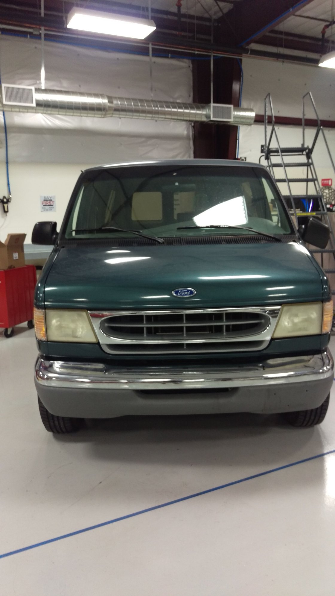

Today is the two month anniversary of my van's self destruction. If I keep my nose to the grind stone I will start the engine today.

My journey is over, at 9:30 AM this morning we started the new V-10 and I drove it home. Smooth as can be. Thanks for all your encouragement.

why didn't you fix the headlights while it was apart ?

On my drive home I did discover a couple of issues I need to address. The E4OD transmission overdrive light is blinking which I understand is the limp home mode indicator. I rechecked my a/c pressures later in the day when the outside temperature was 105 and they were high. I adjust for the temp and took a short drive. The rear a/c quit working on the way home. It's acting like the rear expansion valve is faulty. I did pull valve out and checked to see if it was clean but didn't replace it. My bad as I replaced it several years ago and was saving a buck.
