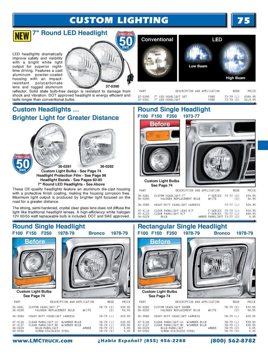

Can't find round headlight buckets huh? Truck Parts and Truck Accessories
If your truck is a 77, and the core support is a 77, the round buckets should go right on. If it is a 78/79 core support and has or had rectangle headlights then you will have to redrill the mount holes to get the 73-77 round buckets to fit.
I believe the indention are there? Repo round buckets are available. Good looking truck, that is for sure.

I bought an original ford core support with round headlight components from a parted out truck. It must have been a 73-77 truck as they are low mount headlights. I have seen the LMC parts but round are shown as 73-77 and rectangle for 78-79. I don't see a mount bracket for a 78. high mount round. I already have complete 78/79 grill with round bezels. When I bought the truck it had a 78/79 shell and round headlights. I'm so over budget on this I'm trying to use what I got.
Below is a youtube video I found of a guy going from 78 to a 75 grill. I might try to get ahold of him. He changed the headlight mount. Maybe the 73-77 buckets fit the 78/79 mount bracket?
