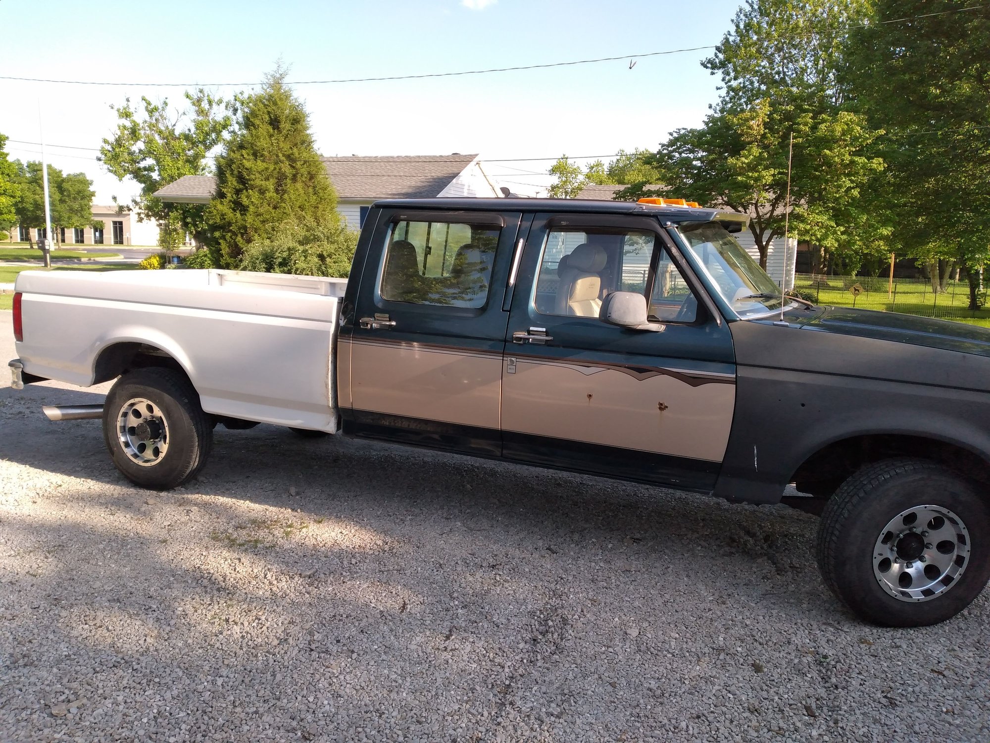

For a while he will look like that. The girls are calling it "combo" now . Lol
Aaron,
I will gladly take any truck you throw together. That looks like a nice rig. I would be proud to drive it.
What exhaust is on there anyway?

As I drive it more I am developing a whole new hit list to go with the list that it's going to take to drag the box . I'm tired just thinking about it.
The exh is a hodgepodge of stuff that used to be on clifford.
The tail pipe is off a buddies dodge and the straight part is just some left over stuff from the project before clifford. The dp is some ebay buy I think. Just junk repurposed.
You are right John. I'll just drive it and be happy.
