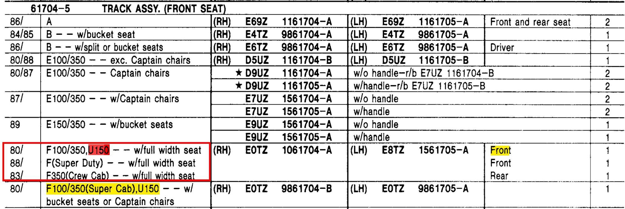

So, I turned to the catalog and, in doing so, came up with a question for y'all: Did the full-sized Broncos have different floor pans depending on what seat they got?
I ask because of what the catalog shows with regard to seat tracks. This snippet from the catalog seems to say that Broncos with a bench seat take the same tracks as a regular cab truck, while those with a bucket seats take different tracks. But, I know that the Bronco bucket seat tracks will not fit my regular cab's floor pan. So, the implication is that the floor pan differed between Broncos with bench seats and those with buckets.
I find that really hard to believe, but am asking for the collective wisdom of y'all. HELP! What am I missing???? If we can get the differences figured out I'll document it.

Ok, this is starting to make sense. Let me see if I understand correctly.
There are two different floor pans - regular cab and crew cab trucks share one, and Broncos and Supercabs share the other. And both pans are drilled for and accept the bench seat tracks. But, the bucket seat mounts attach to the floor in a different spot, and only the Bronco/Supercab pan accepts them. In fact, to directly attach buckets to a regular/crew cab pan requires a lot of drilling and spacing. However, the base or pan for the 40/20/40 seats mounts to the bench seat holes and accepts the bucket seat tracks, so it makes mounting bucket seats a bolt-in arrangement.
Is that correct? And, do all of the Bronco/Supercab bucket seats attach to the pan?
