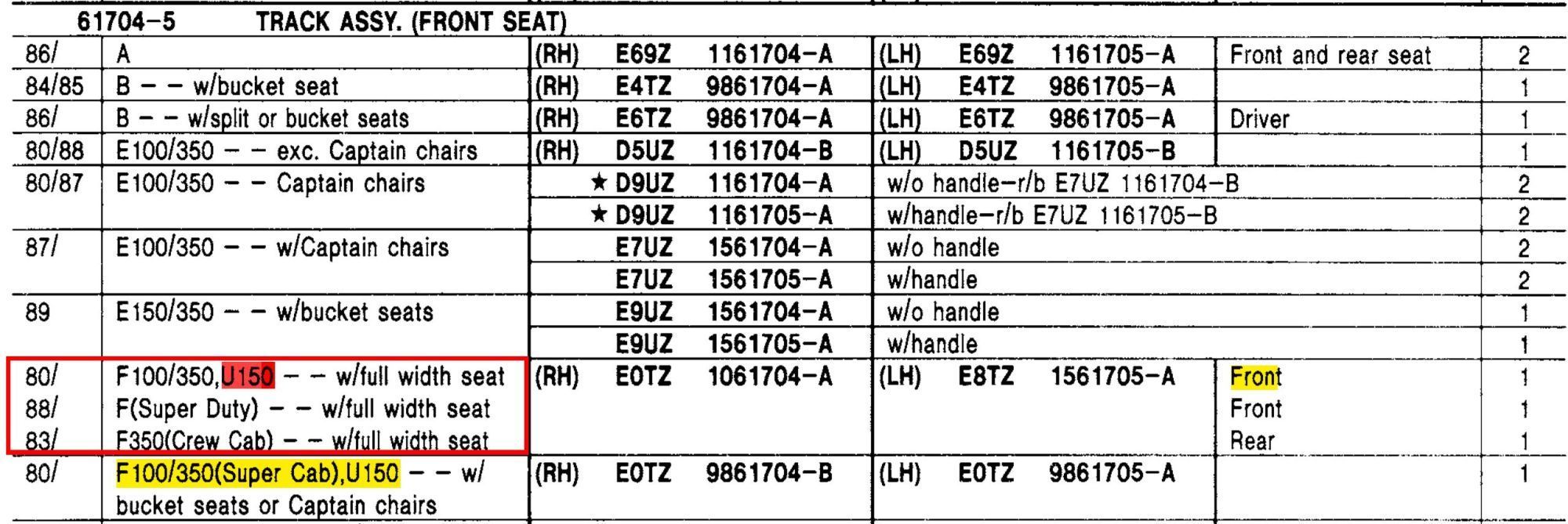

Ok, I think we are closing in on solid answers. My '88 seats won't bolt to the '94+ tracks that came with the 40/20/40 pan, but your '92 seats did. So, some time between '88 and '92 the seats must have changed.
One thought I had was that we could see when the part number for the seats changed. But, Ford changed the part number each year from an E6 for 1986, to E7, then E8, and then E9. So there's no way to tell when the bolt pattern change happened through the seat part number.
That leaves us with the tracks. As shown below, the track assembly for the buckets and captain's chairs were the same from '80 until the end of the catalog's coverage, which is '89. So the holes in the seats had to have been the same until '89. Maybe I can get someone with a catalog for the 90's to figure out when the track change happened. For simplicity's sake, the specific question is did Ford use E0TZ 9861704-B and E0TZ 9861705-A for the 1990 and later bucket seats and captain's chairs? And, when did the numbers change?

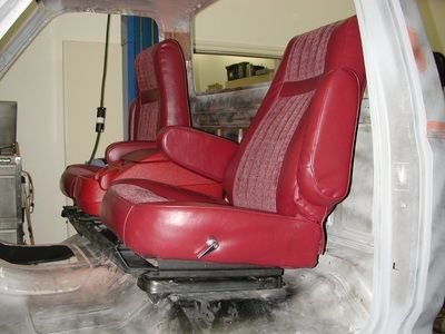

Jerry - I think these are "buckets":
And I think these are "captain's chairs":

Those are your seats?(first one in gates pic?) they look FANTASTIC, and I HATE red
Old Apr 16, 2016 | 09:43 AM
  #40
Gary Lewis's Avatar
Gary Lewis
Joined: Jul 2010
Posts: 32,875
Likes: 48
From: Northeast, OK
Actually, the seats in the first pic are Jerry's/Ozark1. The ones in the second pic are mine. (I think I like Jerry's best. )
