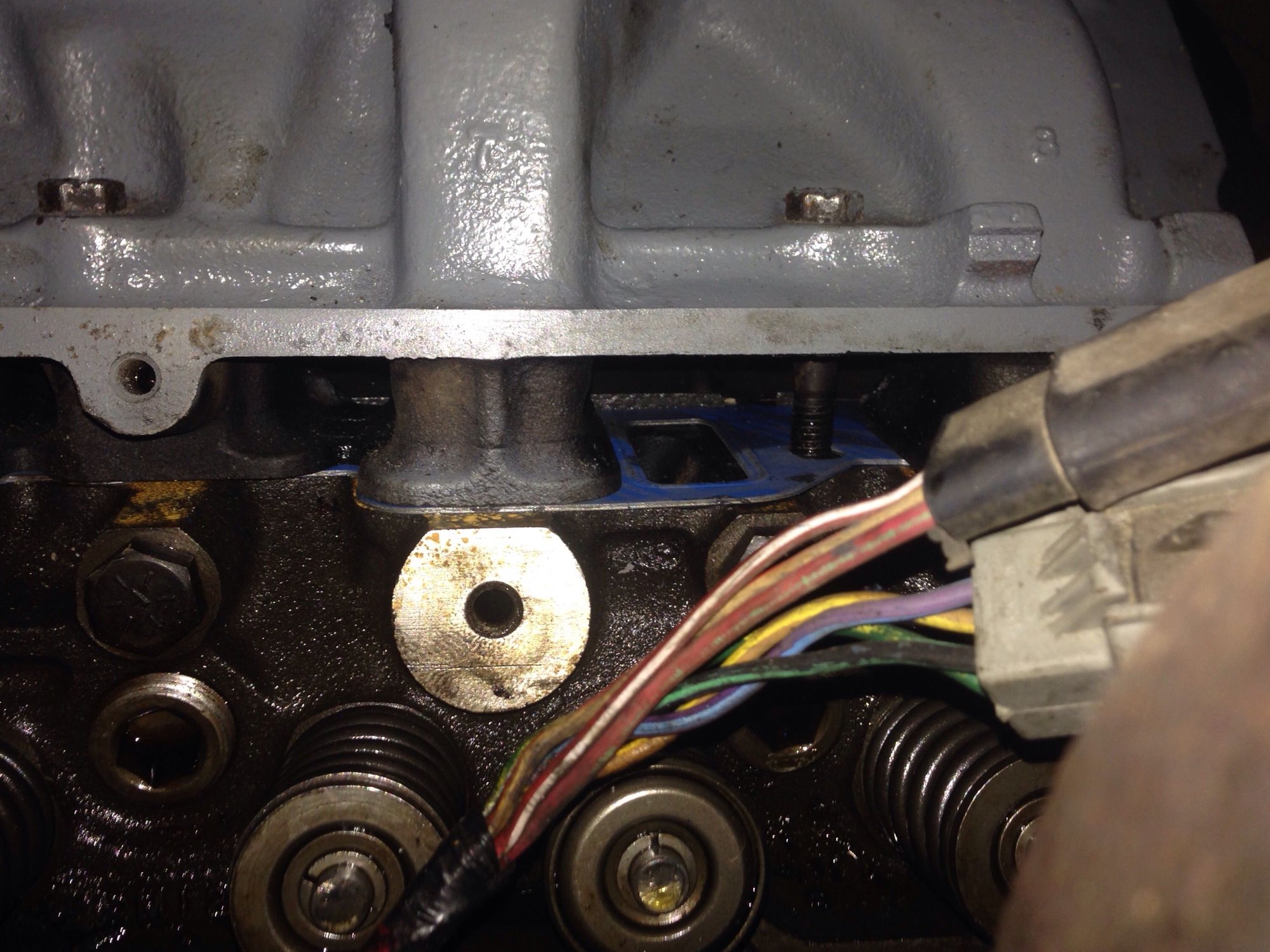

I have a 360 with two barrel I just got a intake off of a 390 with a 4 barrel so I can run it on my truck but it looks like there is a port not being covered by the intake when it's on my block does anyone know if it matters or not

Pictures would help a LOT to answer this question.

Yeah that definitely matters! I'm not even sure it is possible, but is it on backwards? I can't think of any other reason why an intake runner would just be hanging out in space.

I have a feeling you've got a manifold from a 391 FT, not an FE.
A FT manifold will bolt to the FE engines but the exhaust crossover passage won't line up.
No, I wouldn't run it like that. That will let the exhaust pressurize the crankcase.

Can you post any cast part numbers from the manifold. One of the parts gurus could tell you for sure.
