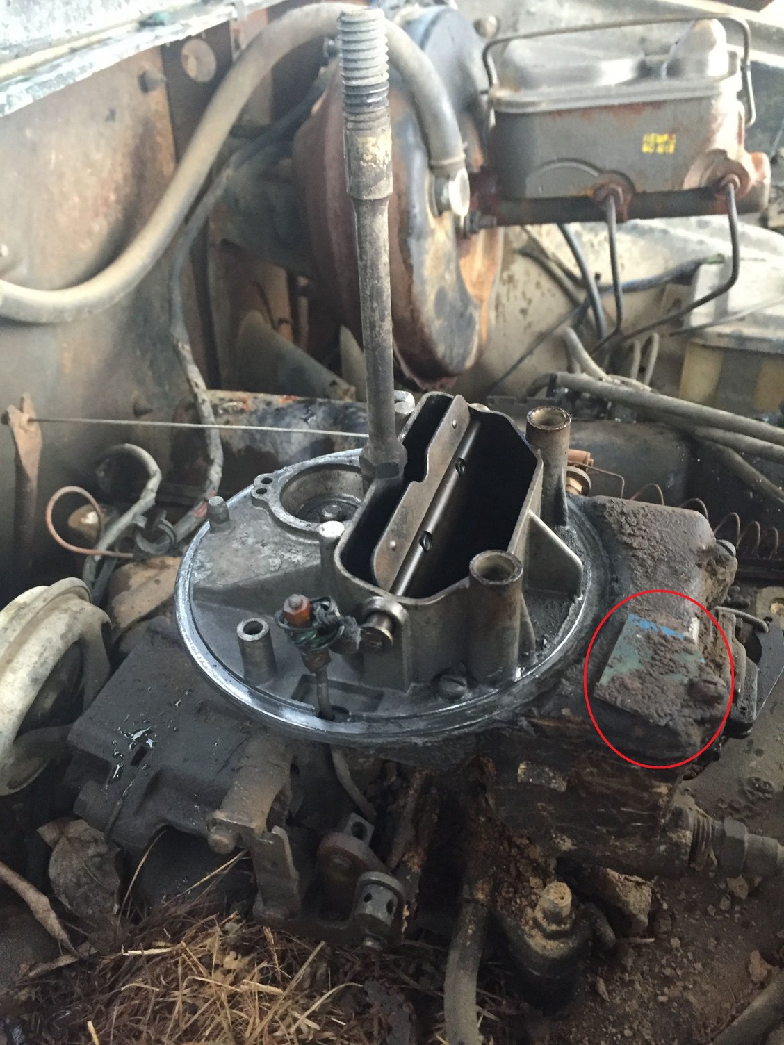

I know these are crude pic, I haven't had time to clean it yet.
Can someone identify this carb from the pics so I can get a rebuild kit?

It's a Motorcraft 2100/2150. Clean off the tag that's attached to float bowl and post the ID number, we can tell you exactly what carb you have.
This is the tag Mike is talking about:

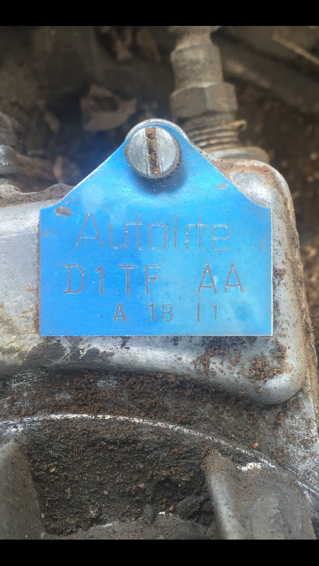

Old Apr 1, 2016 | 12:05 PM
dbiermansr's Avatar
dbiermansr
Joined: Mar 2016
Posts: 17
Sorry I've been running around and couldnt get to the truck til now.
I know it's in bad shape but I just want to get it running for now and look for another one later.
Here ya go.
I'm gonna try that link too.
Old Apr 3, 2016 | 10:27 AM
dbiermansr's Avatar
dbiermansr
Joined: Mar 2016
Posts: 17
I went to the local parts store to see if they had a remanufactured one in stock. All the info they had showed this truck to have a 2150 so It looks like this truck should have had a 2150 Carb on it instead of the 2100. I found a used one on ebay shipped to my house for $60 and a rebuild kit for less than $20. Maybe not the best option but at least now it'll have the right carb and it'll be a fresh one.

Here's that tag number:
D1TF-AA Carburetor Info Page
Looks like it is indeed a 2100.

Old Apr 4, 2016 | 02:30 PM
NumberDummy's Avatar
NumberDummy
Ford Parts Specialist
Posts: 88,826
Likes: 785
From: Simi Valley, CA
Originally Posted by dbiermansr
ID number: D1TF-AA = Ford part number: D1TZ-9510-A .. Auto-Lite 2100 series 2V Carburetor / Obsolete
Original application: 1971 F500/750 & LN500/600 with 330 2V M/D FT engine.
D4AZ-9A586-A (replaced C2AZ-9A586-B) .. 2100 Auto-Lite/Motorcraft 2V Carburetor Kit (Motorcraft CT-499-D) / Available from Ford & auto parts stores.
ALL 1962/74 FoMoCo vehicles.
2150 carb introduced in 1975.
