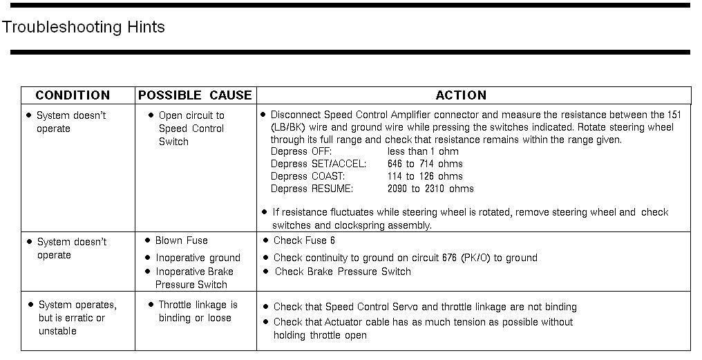

Yes, that is the Brake Pressure Switch that was part of the recall. Since you have the recall harness installed I see no problem with using an aftermarket or OEM BPS.
As long as the BPS is closed with no pressure applied to the brakes it's good.
Diagram of the Speed Control system (Recall Harness is not depicted in the diagram)
Recall Harness adds a fuse inline with Fuse 13
Speed Control Troubleshooting Hints:

Rka2005, thanks for the reply. And thanks for the diagrams and the troubleshooting guide.
That will come in handy.
