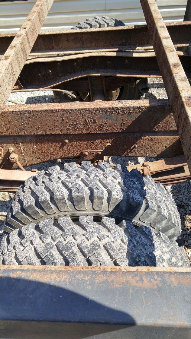

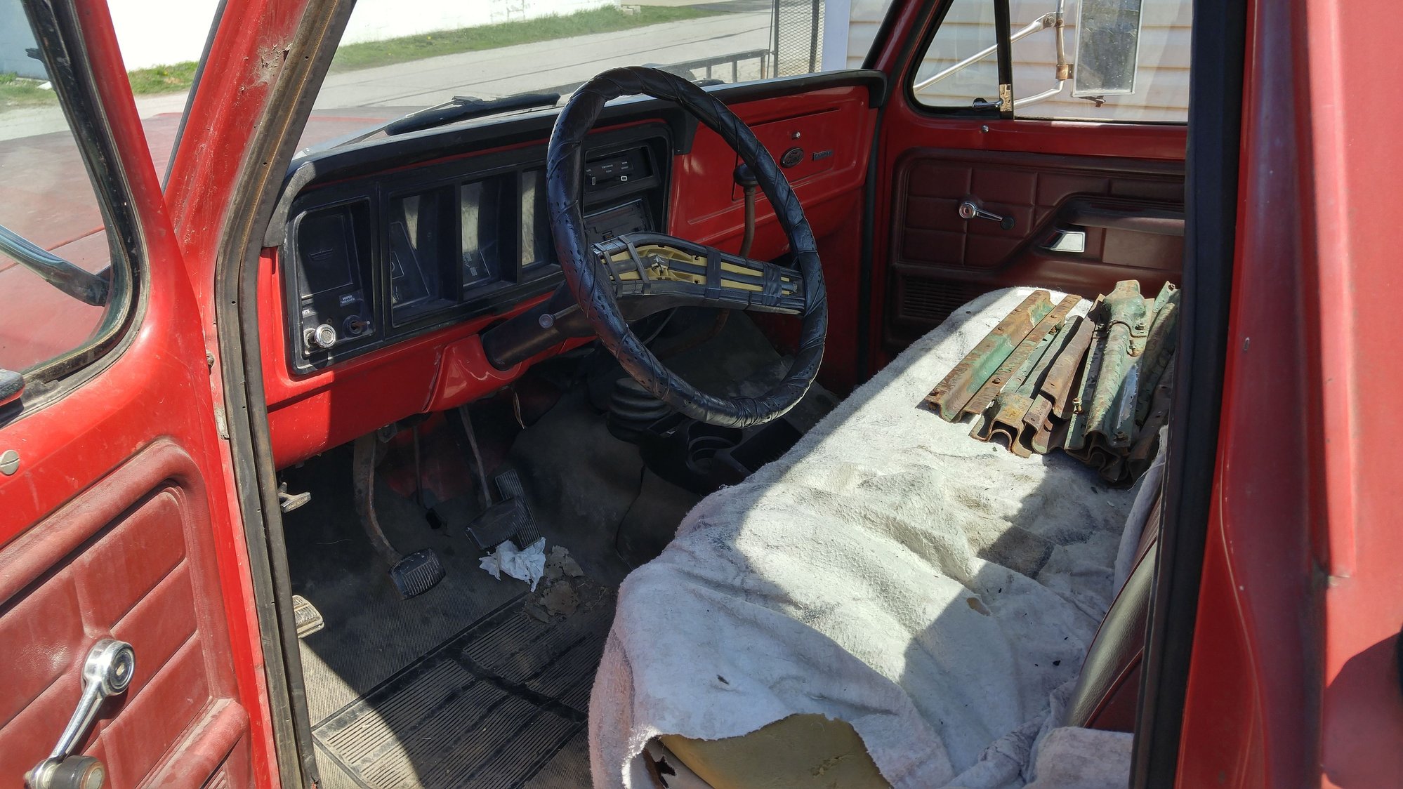

Just found this truck in a shop that we bought for work. Offered the guy a little cash and now its sitting in my driveway.
I know a little about it...360, 1974 i believe.
was wondering if anyone would read this door tag for me, and let me know exactly what i have.
I have included pictures of the truck and tag.
thanks in advance!

Is it just me or is the right cab corner crushed on the cab? Either way it sounds as though you got a great deal. Congrats on that purchase. And you can always find a replacement cab or just a replacement cab corner and fix that yourself. Use it as a learning tool.
