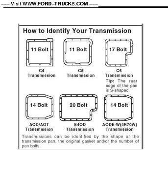

C-6 converter housing patterns. ('Windsor' pattern, 385-series pattern and FE-series pattern). The converter housing of a C-6 is cast integral with the case and unlike a C-4, it doesn't unbolt from the case.
Identification of C-6 by the shape of the transmission pan.
