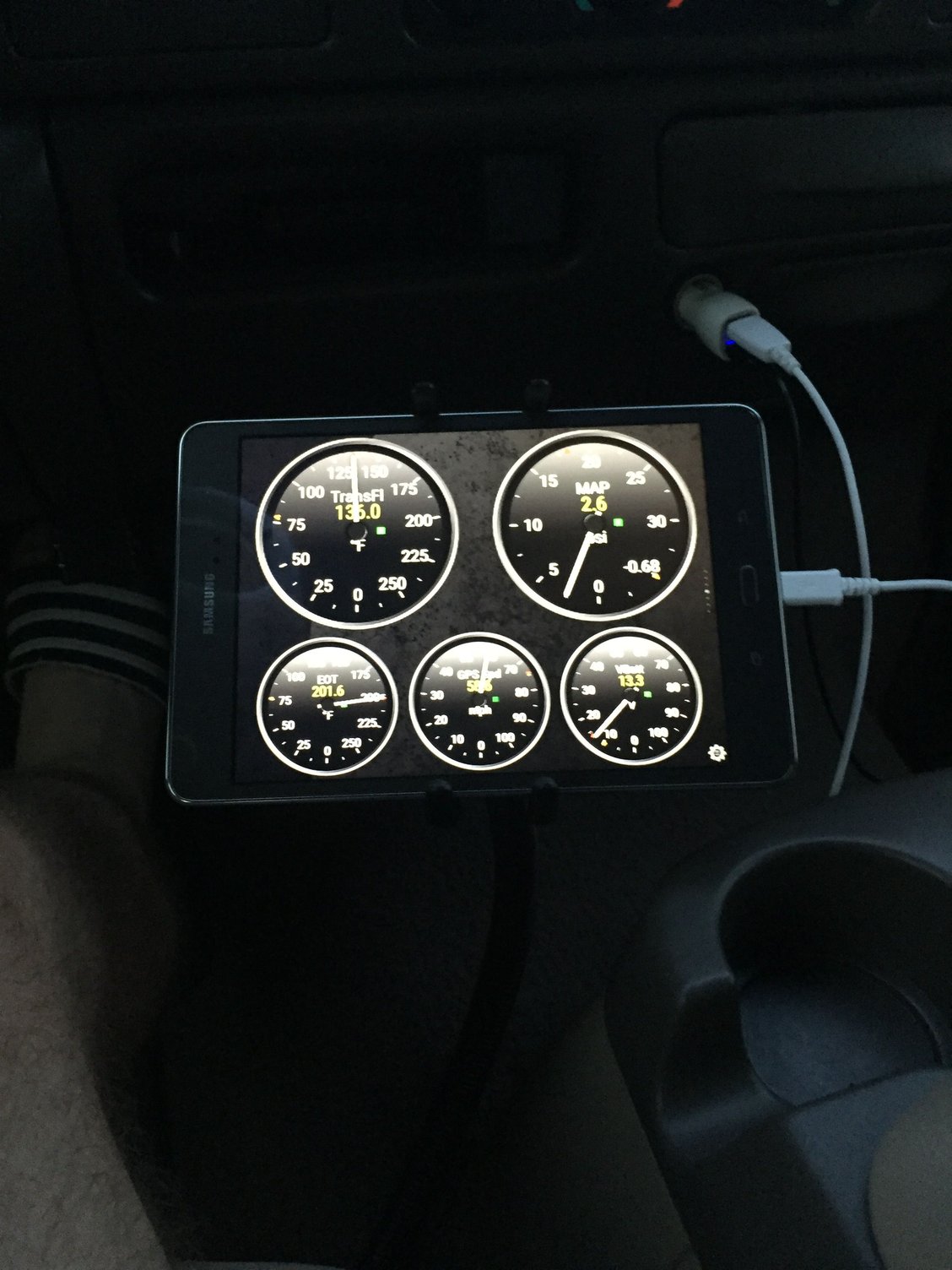

I posted this over in my Excursion maintenance/mod thread. I figured it would get a bit more visibility here.
Over a month ago I tried to set up Torque Pro on an android device. It was less than successful. I didn't play around with it again until this evening. After deleting all the pre-loaded PID's, I picked some of the "standard" PID's available for the 7.3 PSD. They worked this time.
I used the TFT, Boost, EOT, GPS Speed, and Battery Voltage PID's that were already on Torque Pro.
Big question is what formulas did they use? I have no idea if the Boost is accurate, and there were two options on Transmission Fluid Temperature to choose from.
I took a nice little 30 minute test drive at 60-65mph. With 80* outside air temp my transmission never got above 140*, my engine oil hit 201*, and my Boost got up to about 16-17psi at WOT. I don't know how those numbers compare to others?
I went with the longer version of the Arkon iPhone 7 holder. It bolted right under the seat mount bolt and fit my 8" Samsung Galaxy Tab A perfectly.

Those are perfectly normal numbers in an empty truck.
