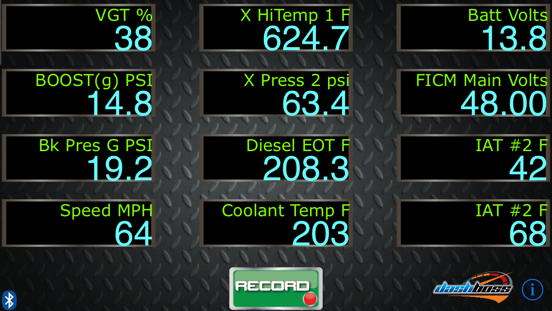

This is at 80 mph, cruise control for @ 20 miles.
Old Mar 6, 2016 | 02:04 AM

This one is st 65 mph - cruise control on and for about 15 miles.

Those numbers look good to me.

Look good to me also.
