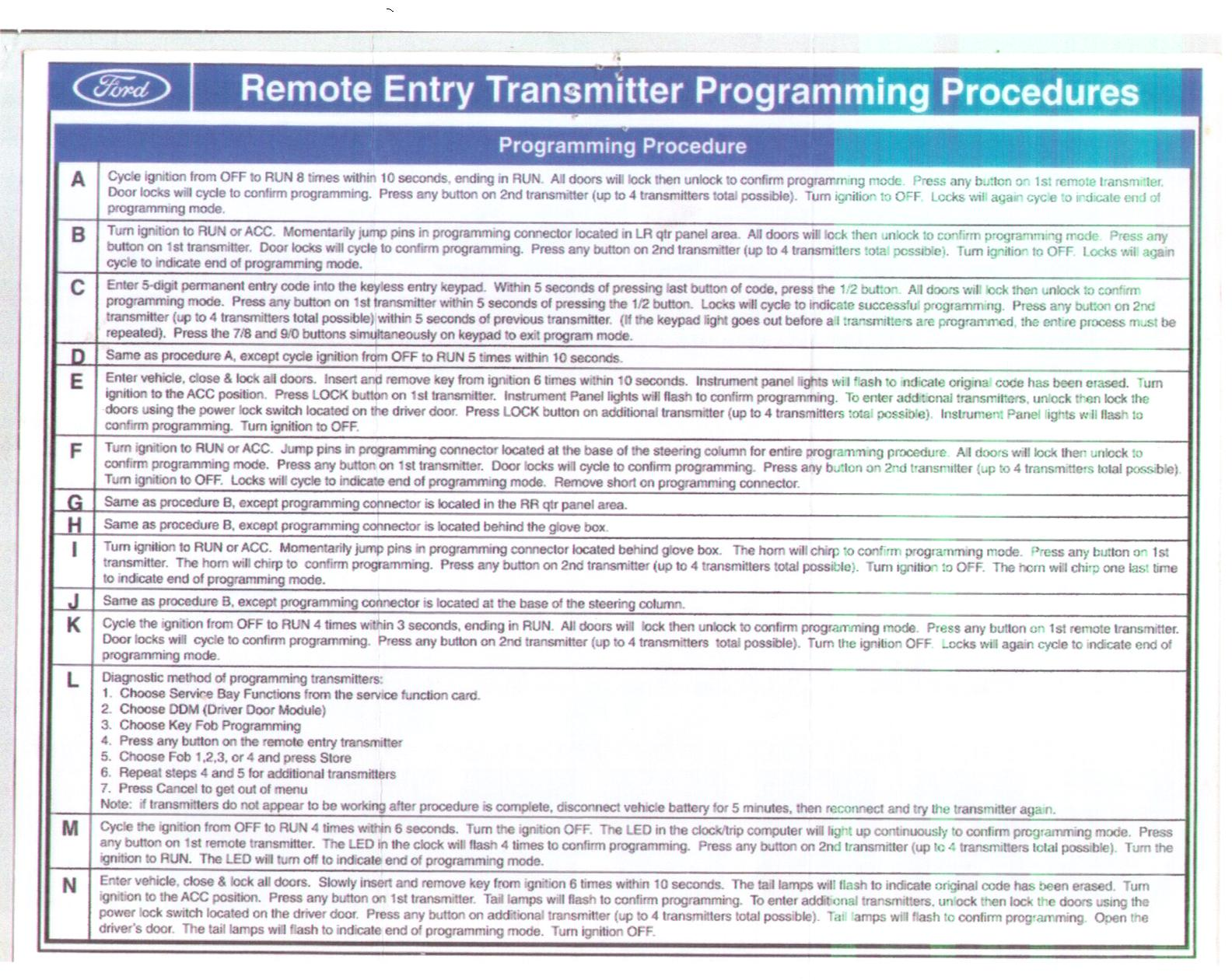

I have a 97 F250 7.3L and wondering if someone has issues with programming wireless entry remote,. I tried the one posted on the net with the off and on 8 times of the ignition... I get nothing. So I went to the 96 and it shows a program connector on bottom of steering column that I cross connect the two wire momentarily. That actually entered the program mode because the door lock locked and unlocked... is suppose to indicate I'm in programming mode. However none of the systems actually finish. The last one is suppose to activate the lock and unlock again when I turn the ignition off but it doesn't and the remote doesn't work either. Anyone know what I could try. I've replaced the batteries in the remote... and the remote that does work the locks still does. I wanted a second one that works and since I have one for a different truck I thought I'd make it work for this one.

These are the instruction for the 1997 F250: First get in Vehicle close all doors and make sure doors are unlocked. 2) Switch ignition from OFF to On 8 times within 10 seconds (on the 8th time leave the key in the on position). 3) Doors should Lock the Unlock indicating you are in program mode. 4)Within 7.5 seconds press any key on first remote transmitter. Doors should lock then unlock indicating process completed. 5)If additional transmitter desired repeat procedure #2 until a maximum of 4 remotes are finished. Then turn off ignition. Note: if door locks do not operate: Wait a few seconds and press the button again. Door Should Lock the Unlock.

These are the instruction for the 1996 F250: 1) Turn ignition to Run or Acc position. 2) Momentarily jump pins in programming connector located at the base of the Steering Column. All doors will lock then unlock to confirm programming mode. 3)Press any button on the first keyless remote, Doors will Lock and Unlock to confirm Programming. 4)IF programming a second remote press any key on second remote. Doors will cycle again to confirm programming. 5) Turn off ignition. Locks will again cycle to indicate end of programming mode.

Even tho my truck is a 1997 the only process that does anything is the instruction for 96. However: it locks do not cycle to indicate remote is programmed and when I turn ignition off it does not cycle the locks either. The first procedure does nothing at all. Anyone know of a different procedure that I might try?
