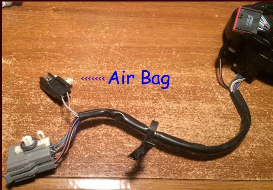

Here is a photo of the clock spring assembly.
The one yellow jacked wire is the airbag and the one to avoid with a meter so
long as it is hooked to the truck or the airbag. Once you go down the column it
is not covered with a yellow jacket but is still 2 wires by them selves.
If you remove the airbag and then go down the column and remove the smaller
2 wire for the airbag and then the larger connector for the horn and switches you
can then safely test for shorted or open wires.
