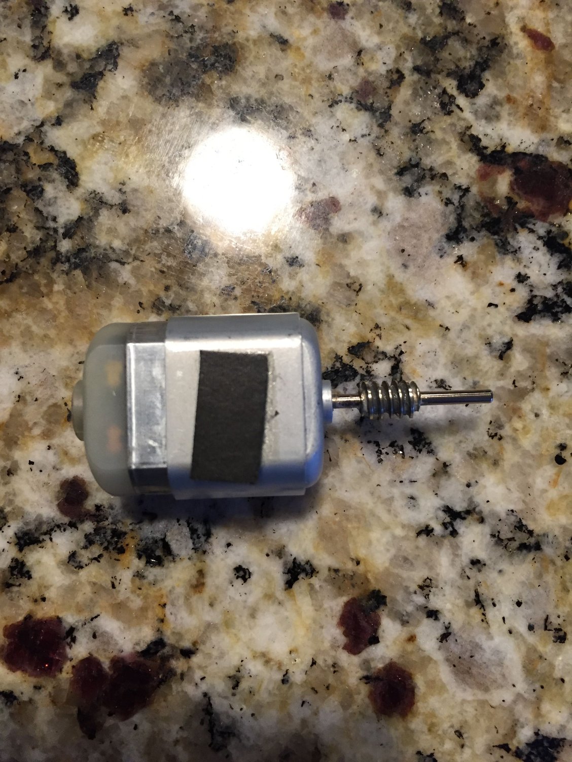

Old Dec 31, 2015 | 03:25 PM
kmonty2's Avatar
kmonty2
Joined: Dec 2010
Posts: 1,318
From: Sterling Heights, MI
This is the motor I pulled out. There are 2 of them in each mirror. The part number the Ford dealership have me is: 7C3Z17D696B<br/><br/>I googled that and there are some on eBay for about $58. Might try that to see if they work.
