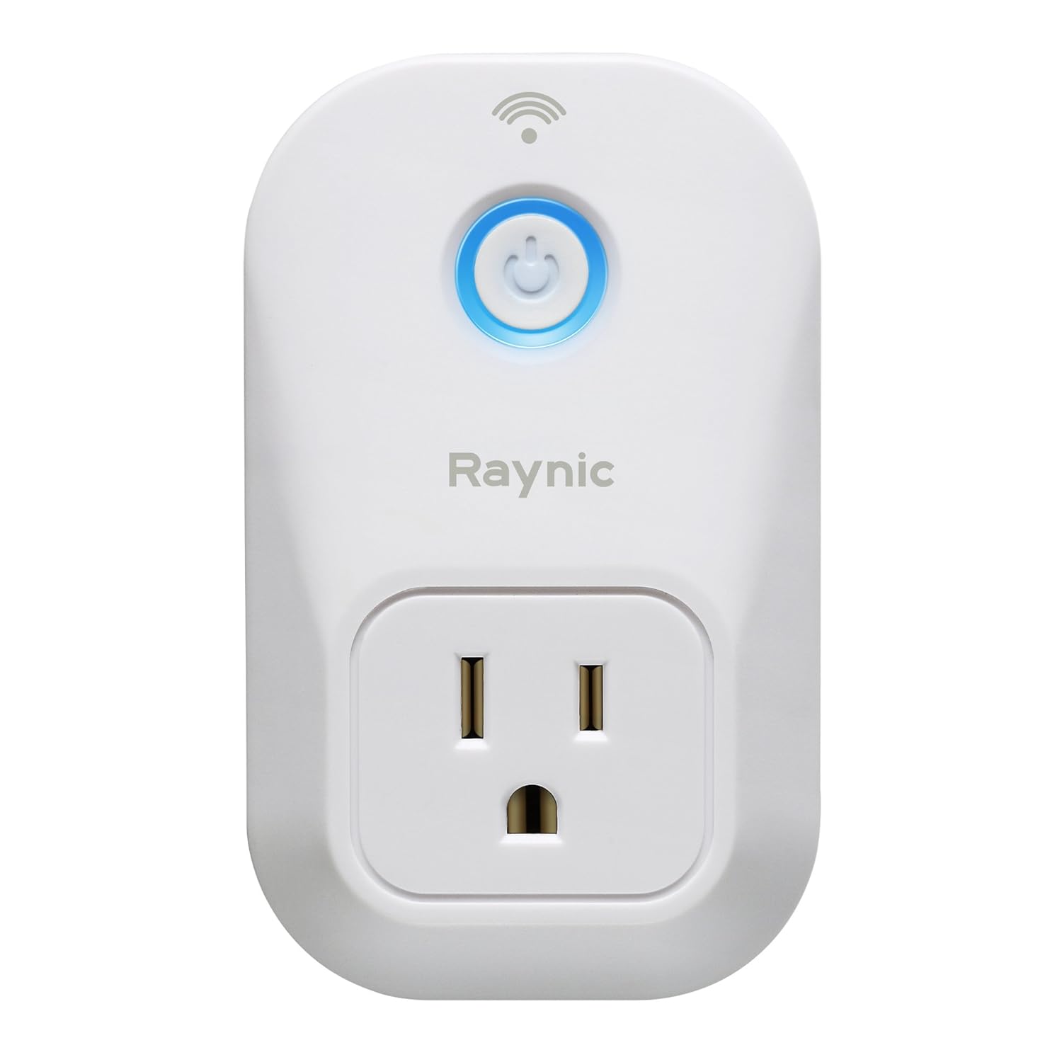

I mentioned an "upgrade": WiFi smart outlet. I grew tired of wrestling with the weekend schedule being different than the weekday schedule. These devices are available for hard-wiring into the wall, or for plugging into the existing outlet - but I haven't found a hard-wired outlet rated at over 600 watts (yet). I suggest the plug-in type anyway, because you can take it with you when you travel. I also suggest this type in the event of failure - you don't want to have to re-wire your outlet as a maintenance item.
Here's a checklist for buying these:
  • If not tech-savvy, is it easy to program?
  • Does it work with my technology - Windows, Apple, or Android?
  • Does it handle 10 amps?
  • Does it keep the programming in the event of a power outage?
  • How many timer events can I put in there?
  • What do the reviewers say about the device?
  • Do I have reliable WiFi signal where I want to put this?
Imagine - programming your truck to warm up on your schedule, not the device's. Also imagine picking up your phone to start warming the truck when your wife wakes up and says "Let's go to Mom's house". The smart outlet might not solve your in-law problems - but it's very helpful in dealing with the balance between warm toes and the power bill.

I have a digital programmable timer on a 25 foot, lighted end cord that works well. With the timer I use it has two outlets so, on one side I have the extension cord and on the other I have one of those plug in electrical socket testers so that with a glance in the garage, I can tell if it's on. The Wifi outlet would simplify this and be an upgrade for sure-Thanks for sharing!
