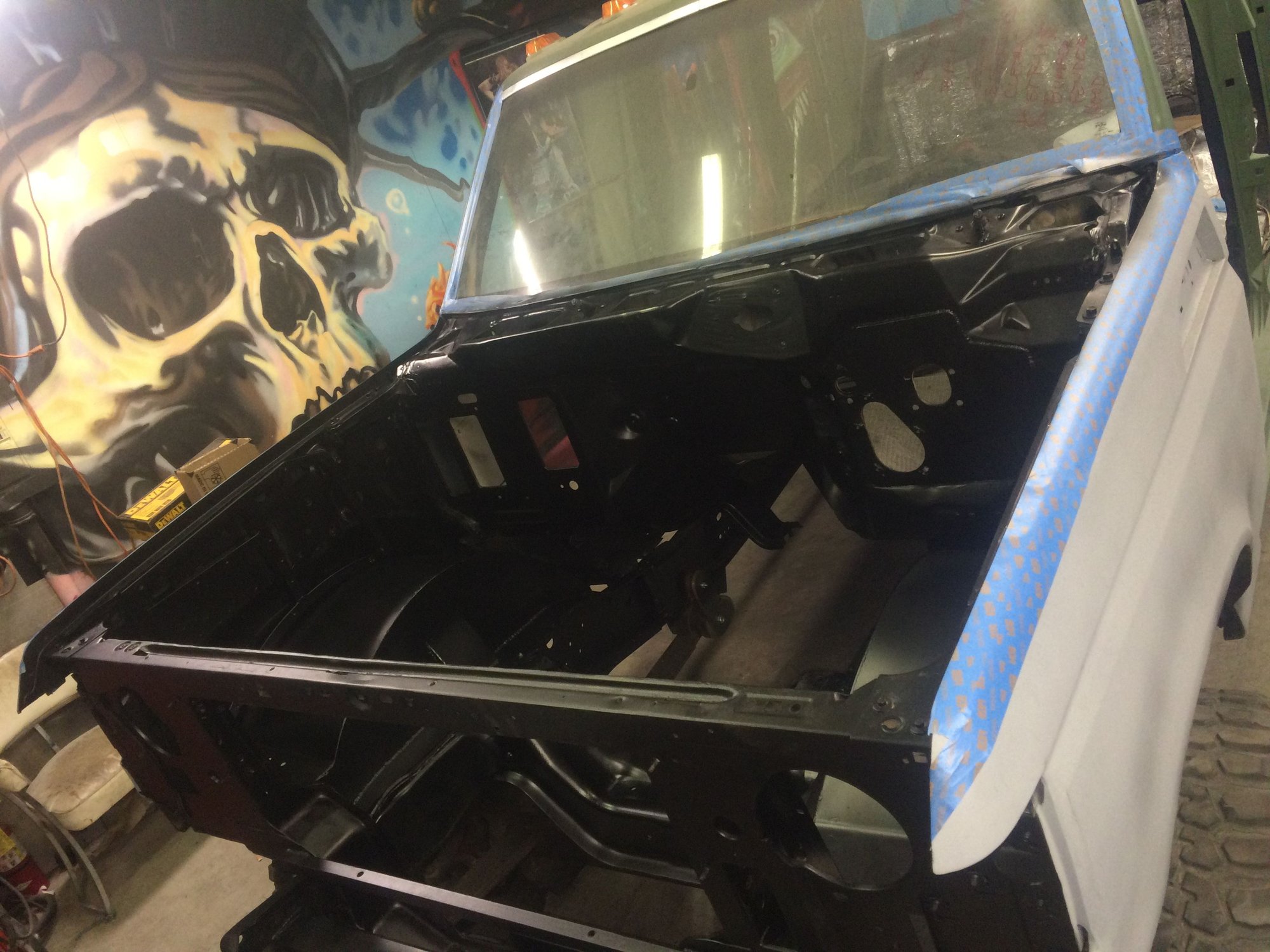

Not that i havent thought about it, but i have to ask, why a 6 door? Theyre neat and all, but i couldnt justify any practicality with it. Looks badass though, and you do nice work.
Old May 9, 2016 | 01:26 AM
  #50
IDIoit's Avatar
IDIoit
Joined: Apr 2015
Posts: 1,264
4 kids. and 2 dogs.
i started building this when the woman was preggo, and i found out they were twins.
we take long journeys to grandmas house and i needed for everyone to be comfortable.
i coulda bought another car, hell i coulda bought 2 with the cash i put into this. but im a sucker for customs.
thanks, i try my best!
