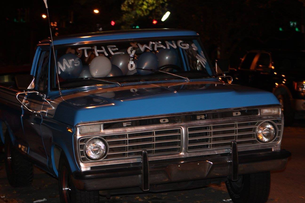

My beautiful bride and I making our getaway.
The handywork of my best friend/best man.
