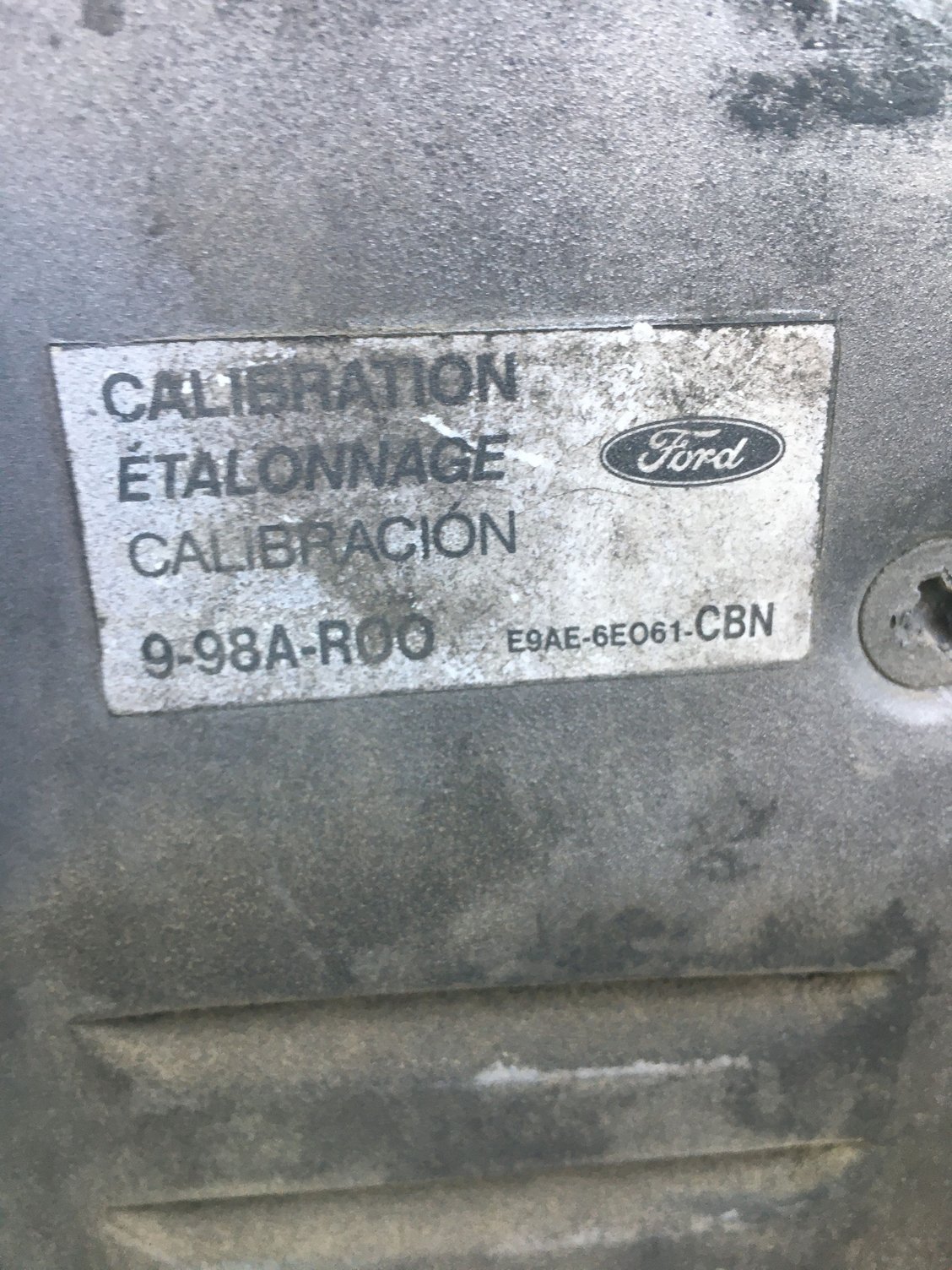

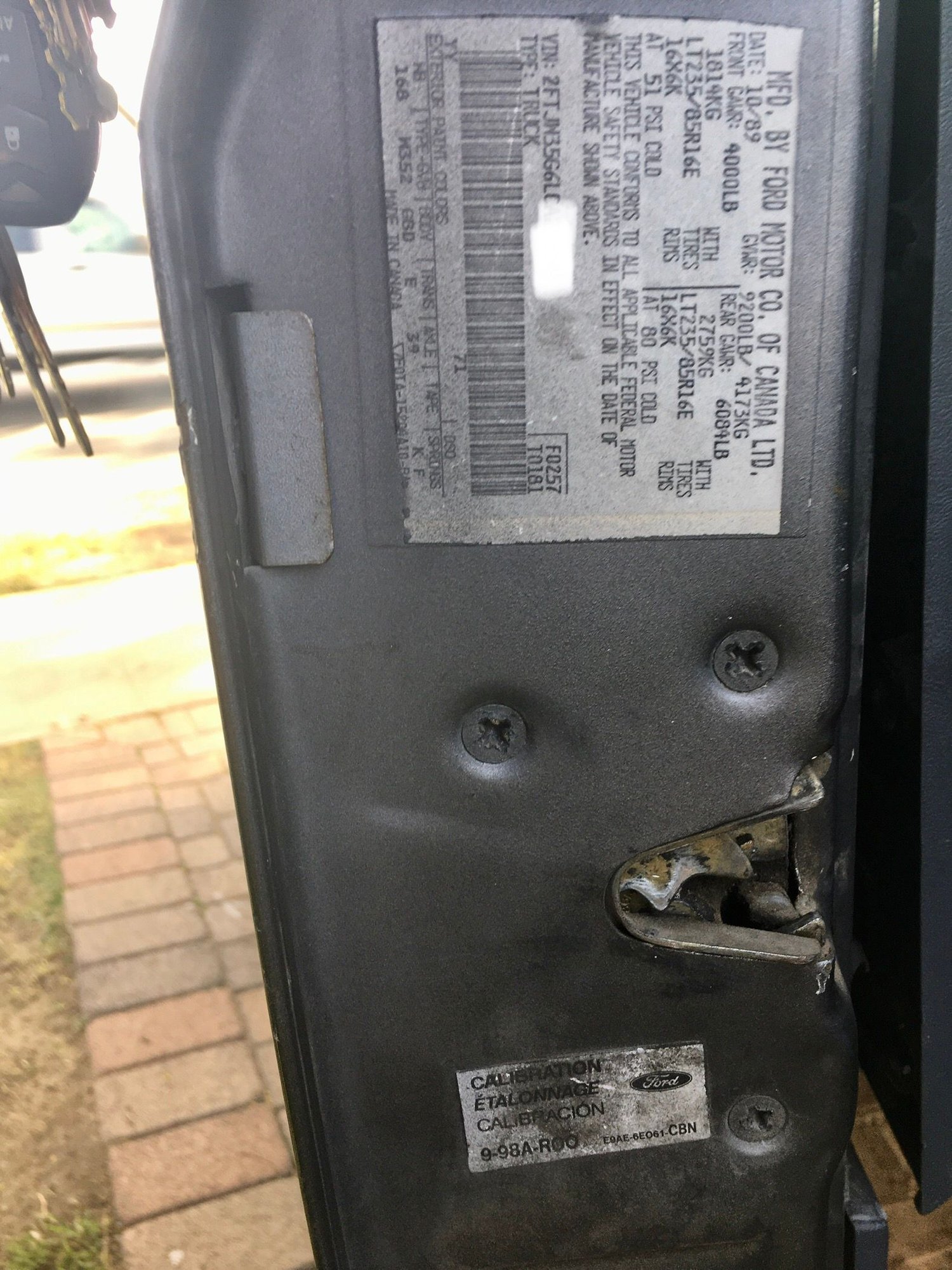

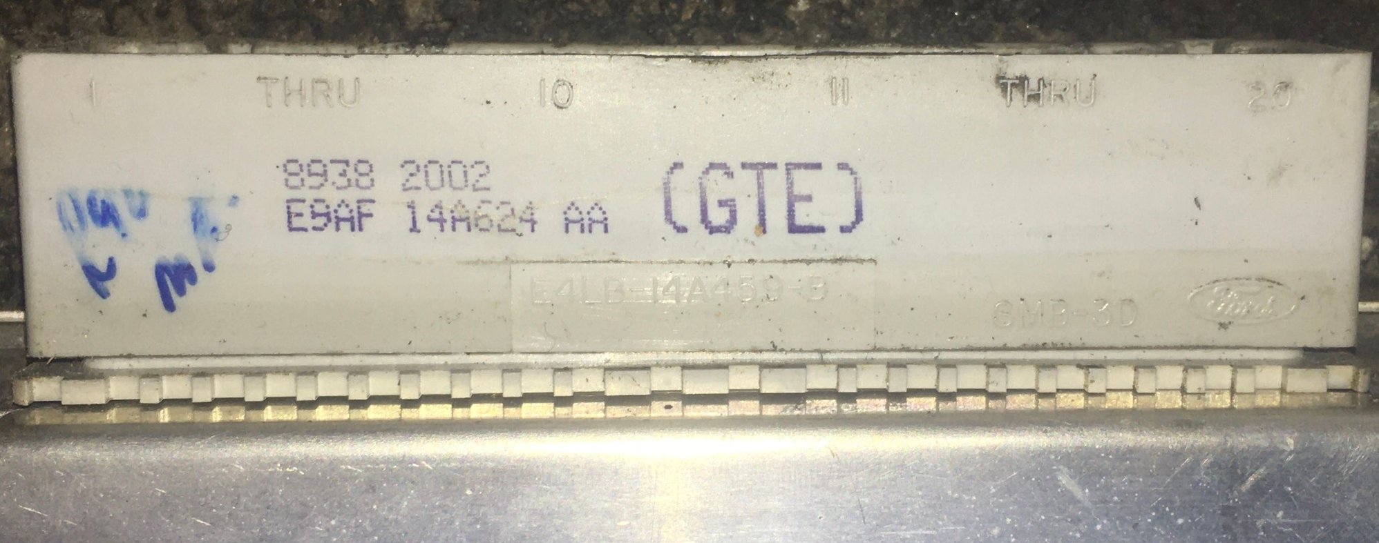

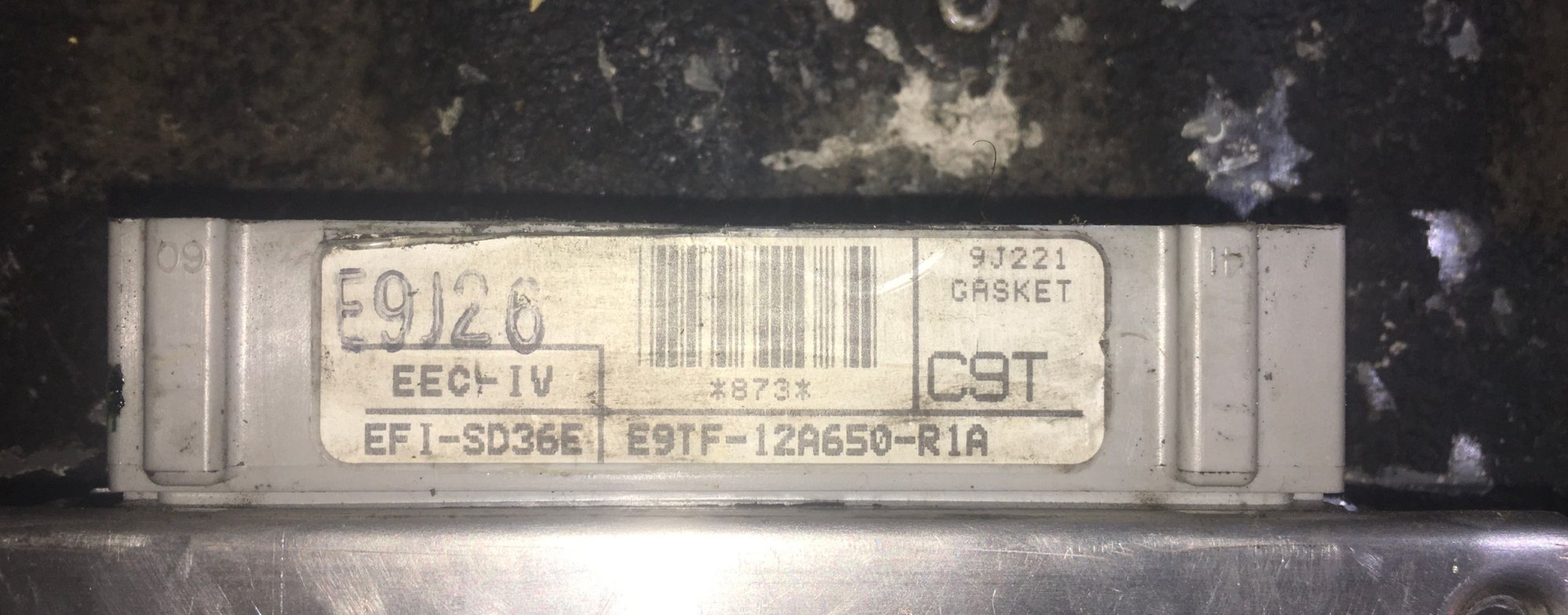

I do not think you should have 2 digit codes with a 1990 f-series 460 with a E4OD.
So it sounds to me like you have the wrong PCM in the truck.
What is the numbers you have on your PCM?
See below.
What is the Calibration code on your drivers door post?
See Below.
The post fix and prefix of your 12A650 number.
Attachment 280788
Attachment 277838
Old Feb 18, 2020 | 02:30 PM
  #35
welder1985's Avatar
welder1985
4wd Low
Joined: Oct 2007
Posts: 12
From: Whittier, Ca
That’s a bit odd to me, from what I understood pre ‘95 is OBD1 and those have 2 digit codes? I don’t use a scanner, I jump the two wires and do KOEO method (maybe I should go buy a scanner, I doubt it will make a difference) . I have been using these 2 digit codes for several years and they have helped in finding a problems.
The ECU / PCM / Computer are all the same Right? The Computer in the truck IS a Stock Ford one, which is 30yrs old...
Here is what I have...

That is the right PCM for that Calibration code.
It just that all the other 1989 and newer trucks an F53 RVs that I have seen with a 460 & E4OD had three digit codes.
