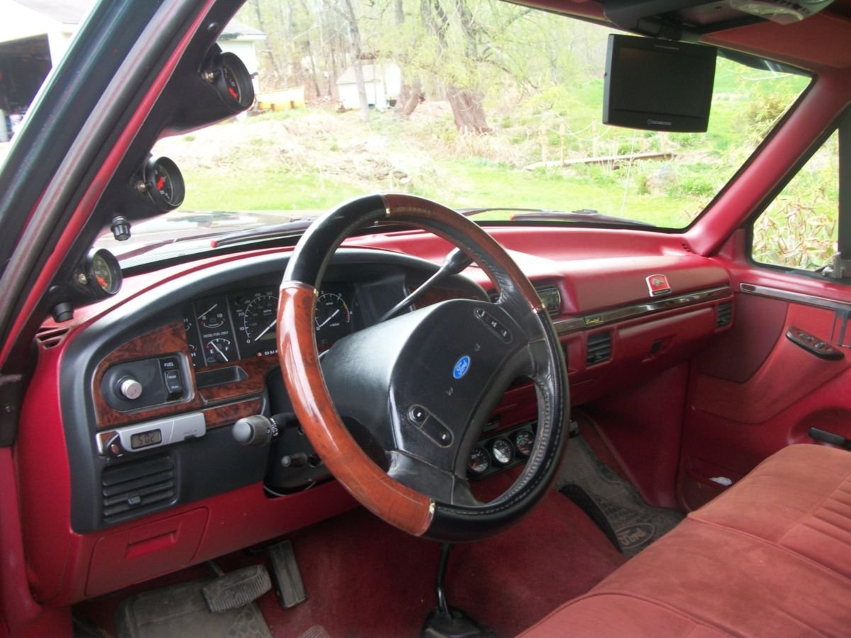

i replaced mine with this back in 2011;
Amazon.com: Keep It Clean 121430 Billet Headlight Switch **** for #HDLSW: Automotive Amazon.com: Keep It Clean 121430 Billet Headlight Switch **** for #HDLSW: Automotive
i dunno about that recent review.when i bought it (exact same one,as amazon shows) everything was included.the ****,the shaft and set screw.
but i dunno why he had such an issue.they sell little set screws in the bins at hardware stores.so his got lost i guess but sounds like he gave up rather than put 5 mins of effort in it lmao.
the only complaint i have with it,is it just a tad bit on the small side to match the hole....but it's very slight issue and it works very good.you can't beat non plastic and a set screw.the way they should of been made.i might even find a pic....................yup.well that was easy to find-
it's pretty universal.im sure amazon/ebay and just the aftermarket in general (sold in all kinds of places.local and online) have loads and loads of options for switch *****.probably silly fun skull ones,glow in the dark ones,lighted up ones etc.etc.etc.google to see what you can find.that's how i found mine.
